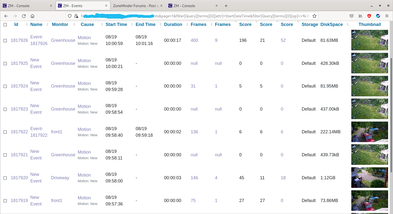

I have an install of 1.37 on a fedora 33 system. I am finding that nearly half the events are corrupt. This is a fresh install with new equipment. Cameras configured properly all imported from older install. I attached a screenshot to show an example of what I mean.
Not sure how I ended up with version 1.37.0 but it is not working.-

Camera settings differ from older ZM and don’t always map well to 1.36 or 1.37.
Start with that and reduce the number of cameras temporarily.

yes it is development version and came in thru a dnf install. I did not realize it was development. But now I have to fix and I am working with somebody on that. Changing the encoding to passthrough was suggested to fix the issue. Not crazy about the idea but if I somehow messed up I have to go thru the fix. so if others are experiencing this they can try the passthrough method instead of encoding. This is done in the individual camera settings under the storage tab.
