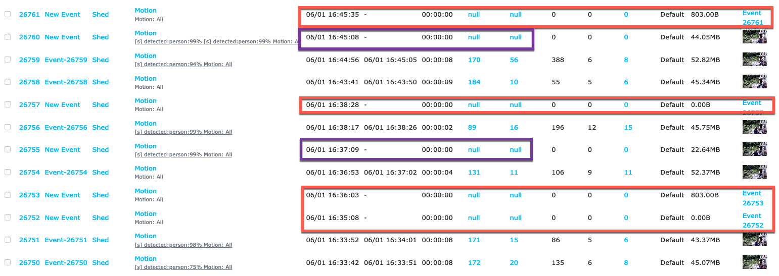

I have just updated from the 1.34.x to the 1.36.x line. (Ubuntu 20.04, ARM64).
I have some issues appearing in the event list :
In red boxes, events are with zero frames
In purple boxes, events show also zero frames, but there is definitely a recording saved.
Any idea where I should investigate more?
The only change I did since upgrading was to manually remove the Maximum Image Buffer Size (frames) into the camera config from 75 to 'empty', as mentioned in another thread.

If you look at my first post, I would like to remove the events boxed in red, because they don't show any frames, and don't have any proper recording. I want to keep the items in purple. They also don't have any frames, but they have a recorded associated
That is the reason I wanted to filter on the event disk space, but I'm open to any suggestion.
