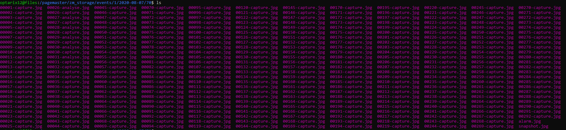

But here is the directory itself, with a max file # of 292:
directory contents.png (27.67 KiB) Viewed 45571 times
From your comment, iconnor, it would appear that Allan and I may have different causes leading to similar behavior.

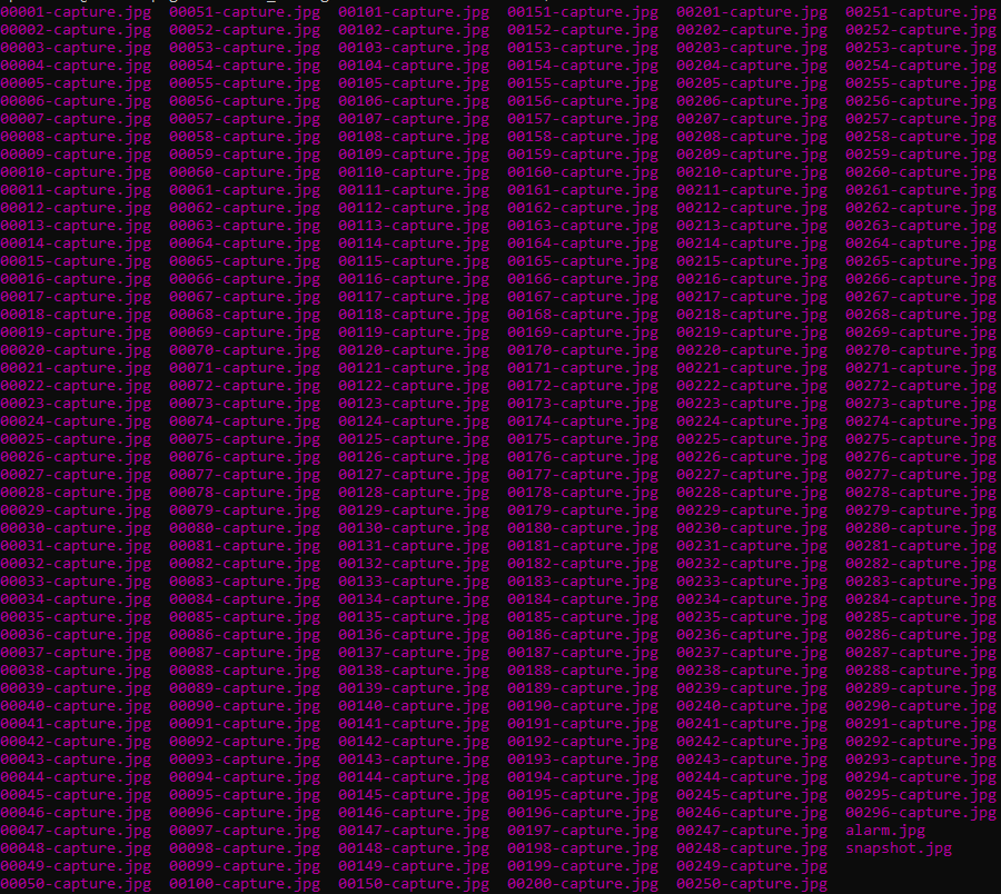

Here is an example where I just forced an alarm manually, and looked at the errors that were generated when I went to play it back in the browser.
Here is the complete directory contents list:
directory contents 2.png (27.57 KiB) Viewed 45567 times

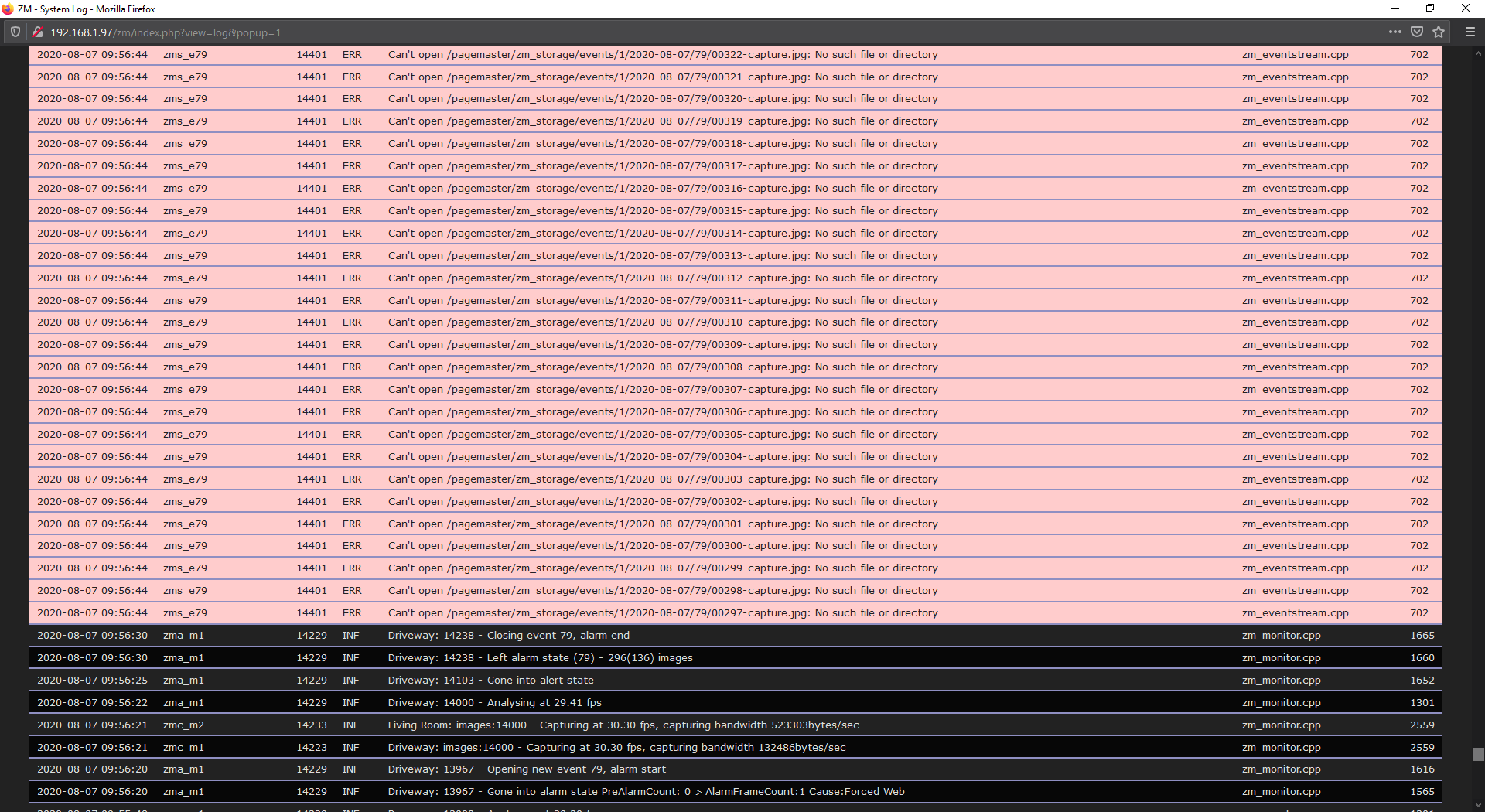

And here is where the errors begin in the log:
Errors event 79.png (138.68 KiB) Viewed 45567 times
There are thousands of errors in the log after that point, all of which generate in just a few seconds. Is there some setting that went wonky, making it mismatched between the rate or duration it thinks its recording at versus what it actually is?
