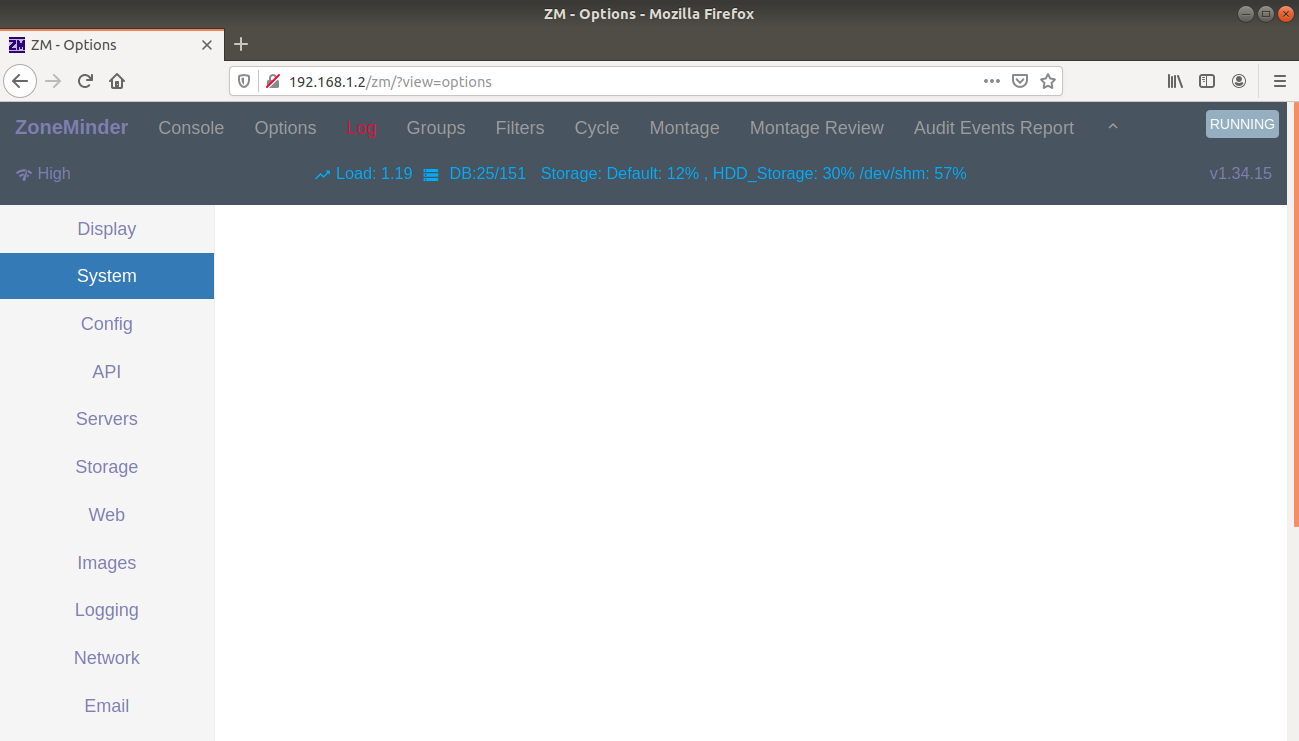

I have done a google search for the above issue, but nothing has been found. I have been using ZM for years and love it. However today I have hit an issue I cant seem to fix.
I upgraded from ZM 1.32 today to 1.34 using ubuntu 18.04 server as the platform.
Now I cannot see anything on the OPTIONS - SYSTEM page to adjust my time zone as It is now running in UTC.
any suggestions would be greatly appreciated.

- Screenshot from 2020-05-23 21-11-18.png (104.5 KiB) Viewed 3080 times

Firefox is showing the same results.
- Screenshot from 2020-05-24 09-23-53.png (61.11 KiB) Viewed 3067 times

I did find the following message in /var/log/apache2/error.log
[Sun May 24 14:31:28.475351 2020] [php7:error] [pid 25790] [client 10.8.0.2:51250] PHP Fatal error: Uncaught Exception: DateTimeZone::__construct(): Unknown or bad timezone (America/Chicago) in /usr/share/zoneminder/www/skins/classic/views/options.php:406\nStack trace:\n#0 /usr/share/zoneminder/www/skins/classic/views/options.php(406): DateTimeZone->__construct('America/Chicago')\n#1 /usr/share/zoneminder/www/skins/classic/views/options.php(429): timezone_list()\n#2 /usr/share/zoneminder/www/index.php(282): require_once('/usr/share/zone...')\n#3 {main}\n thrown in /usr/share/zoneminder/www/skins/classic/views/options.php on line 406, referer: http://192.168.1.2/zm/
Any pointers to where its trying to get the DateTimeZone information would be awesome and much appreciated.

That's interesting.. America/Chicago is perfectly valid.
If timezone is set in php.ini, ZM should still just use that.
Maybe try removing the AMerica/Chicago setting from php.ini....

Thanks for the reply. I had to remove that earlier, as all the sudden the ZM console stopped working all together. Once I removed that config, I could bring the console up, and all the functions are working, but the options - config page....
Very odd indeed.

I would like to thank everybody who gave me tips and pointers.
Not sure how, but while investigating the timezone using timedatectl,
I noticed that it was not beahing correctly when set to America/Chicago.
timedatctl behaved correctly when using another timezone, so I copied a new Chicago file from an existing Ubuntu 18.04 system to the system.
reset the timezone to America/Chicago
That worked correctly with timedatectl.
Then I was able to access the OPTIONS - SYSTEM config page. Very odd stuff.
so set the timezone on that page, and rebooted the system.
Now everything is working correctly..
James
