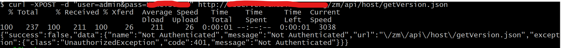

Re: The requested address '/zm/api/' was not found on this server.
Thank you for the timely reply! Alas, No Joy.
I turned off authentication (unchecked OPT_USE_AUTH), and I get Not Found instead of Not Authenticated for the same URL.
Some news: zm/api/host/getVersion.json returns {"version":"1.33.15","apiversion":"2.0"} with authentication off.
