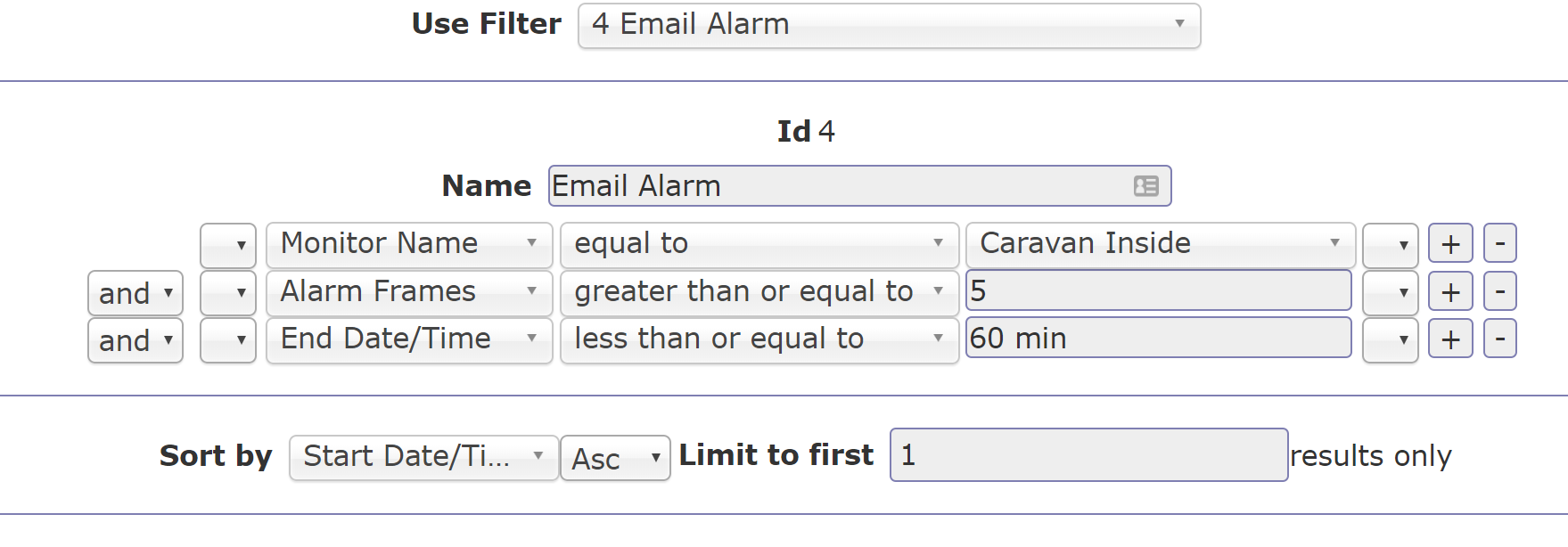

I'm going crazy trying to figure out why my filter doesn't work.
I want to be emailed if an alarm event occurs within a certain time.
Eg. If an event occurred less than or equal to 60 minutes ago.
Here's my filter settings:
I have alarms I've triggered on purpose several minutes ago when testing this but nothing shows up as a match in the filter list.
What am I missing here?

End Date/Time has a value like 2019-01-20 12:34:56
So less than 60min doesn't make sense.
However you can do less than -60min which ZM translates to NOW() - 60mins.
So add a -.

What I'm trying to accomplish is a filter that says "If the event happened less than 60 minutes ago, be a match".
Or put another way, I want ZM to email me only when a new event occurs, not for every event in the past that still matches the criteria of having enough alarm frames. I received dozens apon dozens of emails, so I was thinking I needed to make a filter that says only to send an email if the event happened within the last hour for example.
I tried playing around with - values and it didn't seem to do what I was after. Eg. less than -60min didn't show any matches for events that happened just ten minutes ago.

It could be that "Less than" doesn't mean what you think it means. You're not the first to get caught.
-60mins is "60 minutes ago". (Didn't ZM also support the literal "60 mins ago" ?)
But "Less than" means a time value SMALLER THAN that, meaning over 60 minutes ago.
Try "More than" (yes, that's counter intuitive, language and maths at odds here ...)
