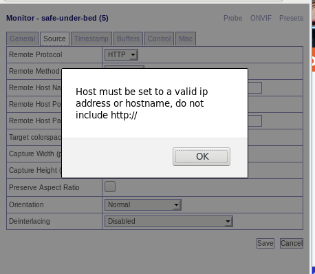

This is what I am trying user=test password=test (dGVzdA==)

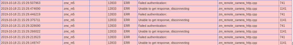

But when I try and save that I get an error.
If I leave it off - blue screen and log shows authentication error

Try source type ffmpeg. Also verify the URL stream in VLC and when it works in VLC check the actual resolution. Be advised that hi res cams can run the server out of memory in tmpfs.
