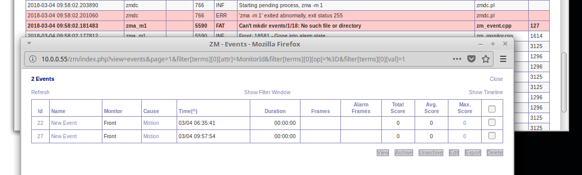

I just set up Zoneminder 1.30.4 and everything seems to be working pretty good.
But I'll frequently get events: "New Event", which never get assigned an index/value, and has zero length. They seem to occur right before a legitimate event occurs, but often the legitimate event will never show up. I've attached a screenshot of the Events page as well as the log entries right at the time of this issue, which I think are related.
Anyone know what might be causing this?
Thanks!

your /var/cache/zoneminder directory with the /events, /images and /temp folders has the correct ownership, permissions and exist?

Yes, and the files are written there with no issue most of the time. I just get the above issue at random times.

I am aware of several issues with saving events. I think you will find errors in your logs that will pinpoint the problem.
Posts: 3368
Re: Often get empty "New Event", zero length
Ah that was dumb of me, you showed the logs that show the problem.
Could be a bad symlink from /usr/share/zoneminder/www/events to /var/cache/zoneminder/events, or permissions.

iconnor wrote: Sun Mar 04, 2018 7:41 pm Ah that was dumb of me, you showed the logs that show the problem.
If it was a directory permission issue, wouldn't it always fail? The fact that it usually works fine, but then-- usually when there are no existing events already listed-- it will occur. Then, the next events will create images normally.
Not sure how it could be a permission issue based on this observation.

To test permissions, yesterday I did:
# cd /var/cache
# chmod -R 777 zoneminder
This morning, I saw the error again, immediately followed by a successful Event.
Is it possible that if the full directory doesn't exist when an event occurs, this error results? For example, the following is a directory where images for 2018.03.05 06:35:16 would get stored after the directory is created:
/var/cache/zoneminder/events/Back/18/03/05/06/35/16
Is there a different process which creates the directory? It seems the error doesn't occur if the full directory already exists.

it does appear that the /events directory is not writable at that moment....partition not mounted or some symlink problem between the monitor events as a name or as id #. I seem to recall not to long ago a thread dealing with something of that sort...... I am just throwing out some ideas.....

Also, please note, the Events get created just fine most of the time. It's just the very first image/event at a particular time seems to have the issue.

We need to get a better understanding of your complete setup.
Can you provide the following data?
- total number of active cameras in your system
- resolution and framerate of each camera
- what cpu is in the machine and what is the average system load?
- How big is your ramdisk /dev/shm and how full is it?
- verify max fps fields & analysis fields under each monitor config are blank for now.
- Please show an entire page of unedited, unfiltered log entries showing all events prior to and just after the error shows up.
- Describe the disk you are writing events to and its filesystem. Is this the local disk, an external drive, or network fileshare?
In another thread you mentioned you are using an older Dell laptop. Recommend you scan the entire disk for bad sectors. A failing disk can cause the symptoms you have described.
