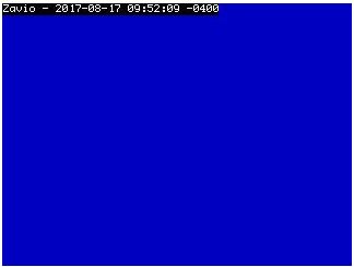

I am running a new installation of 1.29.0 on a raspberry pi3 box and am having problems displaying 2 of my 4 cameras. I have a dlink and foscam that work fine. I just acquired a Hikvision DS-2CD2122FWD-IS and also a Zavio B6210 but I can't get a good feed with ZM. If I load the source path into my VLC player on my windows laptop, I have a perfect stream for all the cameras.

Sometimes the zavio is all blue and sometimes it looks all distorted like the hikvision. I have tried a few different stream formats but am still getting the same results.

Source Path - rtsp://login:password@ipaddress//Streaming/Channels/101
Not sure if this is just a typo, but you've got one too many slashes after ipaddress.
The camera configuration in ZoneMinder is set to 320x240 resolution, but are the two cameras in question actually sending 320x240 streams to ZoneMinder? If not, that's the problem.
Open each camera in VLC player again and then note the resolution reported by VLC. This has to be exact, down to the pixel, and it may not be the same as the advertised resolution.

miket0813 wrote: Thu Aug 17, 2017 4:43 pm So which do I use, 1920x1090 or 1920x1080? Anything else that I need to note?
Some of my cameras do the same thing. I use 1920x1090.
Frame rate is important. Recommend you set all your cameras to 5 fps or less since you are running on a raspberry pi.
Since the pi only has 1GB of ram, you also have to watch your memory. HD cameras eat up a lot of your ramdisk.
df -lh /dev/shm
Will tell you how full your ramdisk is. Further details are mentioned in my blog.

Ok, thanks for the info. Here is my df output:
tmpfs 462M 383M 79M 83% /dev/shm
That is after I removed the Zavio. Not looking too good.
I tried to give the cameras 5 FPS but they all wen't wonky and digitized. The Hikvision went blue. I removed the 5 from the FPS field and all seems well.
Re: Two cameras won't display feed
Make sure you set the frame rate in the camera's web portal, not in zoneminder.
You can increase the size of /dev/shm a little in your fstab, but you can't go too far or you steal memory away from the operating system which will cause other problems. Lower your image buffer from 50 -> 35 for each monitor. That will use much less ram.
