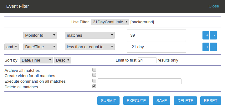

Trying to setup a filter that deletes a certain monitors events older than X days.
Event Filter setup as follows
Screenshot at 2017-07-28 23-00-10.png (28.05 KiB) Viewed 4352 times
Using Submit returns the expected results, however, when saved and allowed to run in the background zmfilter throws the following error:
2017-07-28 22:50:10.701910 zmfilter 11667 ERR Error parsing Sql. skipping filter '21DayContLimit' zmfilter.pl
2017-07-28 22:50:10.700960 zmfilter 11667 ERR Error parsing date/time '-21 day', skipping filter '21DayContLimit' zmfilter.pl
What am I missing?
Thanks in advance
Re: Error parsing date/time - Filter issues
Try it w/o the negative logic.
Set your Date/Time expression to be greater than or equal to 21 day to delete events older than 21 days.

Try "Date/Time" "Less than" "21 days ago" (older than 21 days) ?

@miikb's suggestion works and is nicely "readable"; I'll probably stick with that.
But get this....
I removed the space between the quantity and the type and it's working as well.
"Date/Time" "Less than or equal to" "-21day"
Thanks all for the help.
Solved!
Glad you got it working, but you probably did run across a bug.
Previously, I just wanted you to remove the negative to see if that was causing the issue.
It seems this line if returning false:
https://github.com/ZoneMinder/ZoneMinde ... pl.in#L211
Curious if you could find the filter in your database, and post the sql string verbatim.
