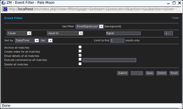

there is a parameter in Filters that is called "Cause". I use this as a rule condition that acts like
if Cause = "Signal" then do something
here is an example attached
I have a wifi netcam that loses connection once in awhile and will not recover sometimes and I noticed that the cause is "Signal"
so I use the cause rule also not to send and event email due to a signal loss but seems like one could actually use it to send a notice of camera failure.

This filter Cause= Signal only exist when a camera comes back online but not when when the connection is lost
