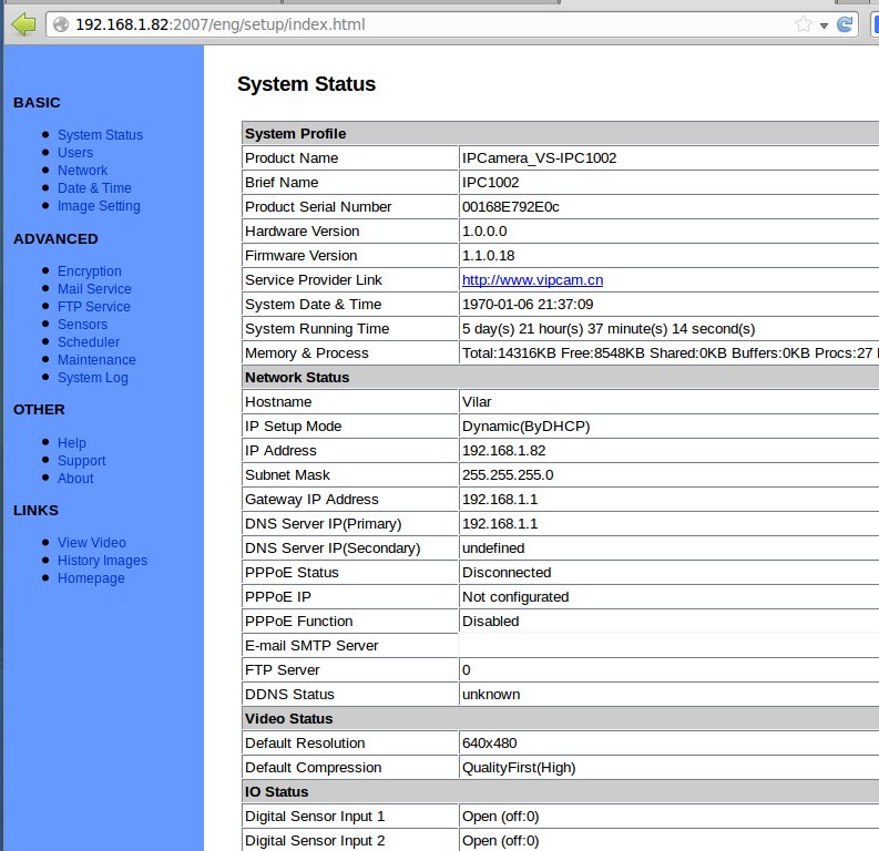

Hello friend!, This is the information I could find my ptz dome, tell me what else could possibly need to facilitate the resolution of my problem ..
Status page:
Camera control page:
PTZ separate control:
HTML code PTZ control:

In the code above it is clear that for each action uses an image and different variable, but nose how to implement it in the zoneminder ...
Also you step team page, but do not give much information, and less of the .cgi ..!!

aodiaz
Posts: 26
Joined: Thu Apr 25, 2013 3:38 am
Location: Argentina
Re: Vilar mini domo cam (ip camera)
Post by aodiaz »
A correction of code to ZoneMinder versions higher than 1.26
At line 85 approximately reads:
#$self->{ua}->agent( "ZoneMinder Control Agent/".ZM_VERSION );
and replaced by the following:
$self->{ua}->agent( "ZoneMinder Control Agent" );
ZM reboot to take changes!!
FIX VilarCam IPC1002 , version 1.28 ZoneMinder, January 2015, by aodiaz
aodiaz wrote:A correction of code to ZoneMinder versions higher than 1.26
Rather than delete ZM_VERSION from the agent, a better solution is to follow what we did with the control scripts packaged with zoneminder:
https://github.com/ZoneMinder/ZoneMinde ... cIP.pm#L80
The example references the full package name "ZoneMinder::Base::ZM_VERSION" instead of just the bareword ZM_VERSION, which was depreciated.
