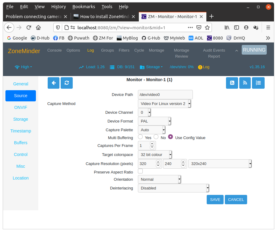

Using the guvcview or cheese software check whether the device path of usb camera is /dev/video0
Please check the usb monitor settings with the following pictures .
Screenshot from 2021-01-15 11-51-31.png (104.13 KiB) Viewed 42061 times
Screenshot from 2021-01-15 11-51-45.png (117.07 KiB) Viewed 42061 times
Screenshot from 2021-01-15 11-51-55.png (114.86 KiB) Viewed 42061 times
In the zoneminder panel goto Options>TIMEZONE and select your timezone and save
Restart zm
sudo docker restart zm
sudo docker exec -t -i zm /bin/bash
dpkg-reconfigure tzdata
Then select your timezone
exist
