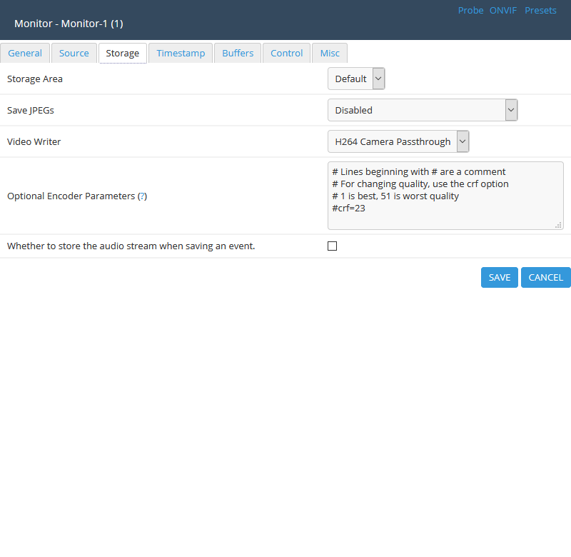

... and so fare I can not connect zm to the cam
want2see
Posts: 13
Joined: Sat Oct 24, 2020 10:59 pm
Re: New camera
Post by want2see »
Here are my exact settings (without password):
