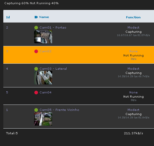

Re: ALERT - Major UI Changes - Work in Progress
New features are looking really great !!!
Just one suggestion. Why not put thumbnail in a new column ? I think between ID and Name and centralize data on row.
