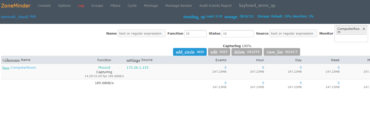

However, the gui is a bit off, there are words instead of icons for a lot of things and I see these errors in the log.
04/07/20 10:55:43.851826 web_php[13517].WAR [172.26.0.21] [Failed linking skins/classic/views/js/state.js to skins_classic_views_js_state-base-1583524358.js] at /usr/share/zoneminder/www/includes/functions.php line 2216
04/07/20 10:55:43.854640 web_php[13517].WAR [172.26.0.21] [Failed linking skins/classic/js/base.js to skins_classic_js_base-base-1583524358.js] at /usr/share/zoneminder/www/includes/functions.php line 2216
04/07/20 10:55:43.856759 web_php[13517].WAR [172.26.0.21] [Failed linking skins/classic/js/skin.js to skins_classic_js_skin-base-1583524358.js] at /usr/share/zoneminder/www/includes/functions.php line 2216
04/07/20 10:55:43.858849 web_php[13517].WAR [172.26.0.21] [Failed linking js/logger.js to js_logger-base-1583524358.js] at /usr/share/zoneminder/www/includes/functions.php line 2216
04/07/20 10:55:43.860888 web_php[13517].WAR [172.26.0.21] [Failed linking skins/classic/views/js/console.js to skins_classic_views_js_console-base-1583524358.js] at /usr/share/zoneminder/www/includes/functions.php line 2216
