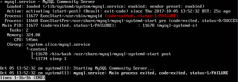

systemctl -l status mysql

Output of systemctl -l status mysql is : not seeing much wrong in the sql log except for the timeouts (which I guess is after the crash) syslog has errors around Buffer I/O. My filesystem has gone read only so can't install ssh and grab the log files.
