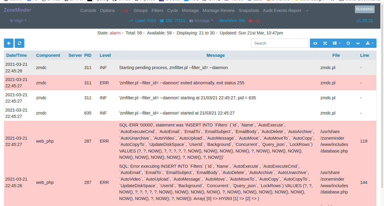

Test run on Zoneminder master 1.35.21~20210321091944-focal
Date:- 21-3-2021 / 22:45 PM
Results:- Filter creation failed.
Error log :-
Screenshot from 2021-03-21 22-47-05.png (205.88 KiB) Viewed 210405 times

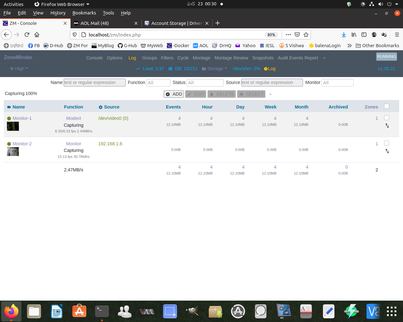

The Emailing and uploading can be done
Screenshot from 2021-03-23 00-31-16.png (292.79 KiB) Viewed 210349 times
Screenshot from 2021-03-23 00-30-36.png (251.21 KiB) Viewed 210349 times
Screenshot from 2021-03-23 00-30-53.png (276.82 KiB) Viewed 210349 times
