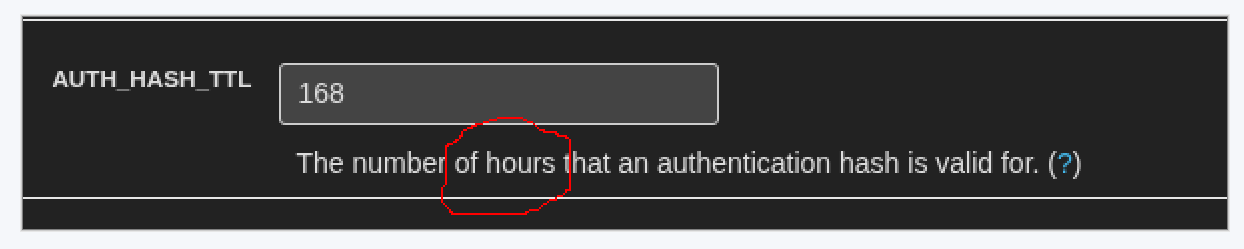

In which case, it looks like the documentation needs to be corrected. Please see the attached screenshot:

You are right of course . Why have you felt the need to increase it from 2? I assume to stay logged in longer...

That's correct. I can only get a session length of 7 days when I set COOKIE_LIFETIME to 604800 (number of secs) and AUTH_HASH_TTL to 168 (number of hours)
