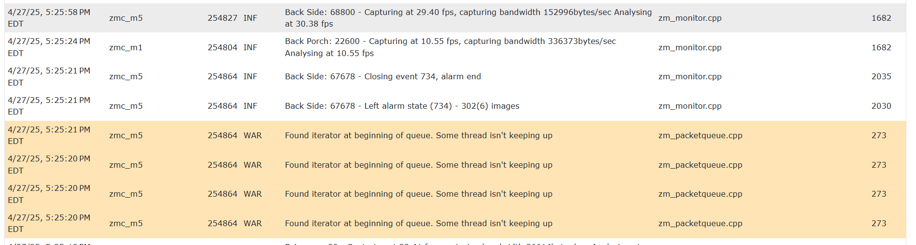

Found iterator at beginning of queue. Some thread isn't keeping up
I get this warning every time an alarm goes off on every camera

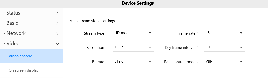

First thing I did was went into the camera settings (not in zoneminder) and turned down the frames. From what I found searching the forums is that the Frame Rate doesn't need to be so high (not making movies) so I set mine to 15. Then the Key Frames should be 2xs that number so I set that to 30.
This did not solve the iterator issue but it certainly fixed my CPU usage issue, everything on my server looks so much butter and the ZM load went way down. Live stream doesn't look too bad with these settings either.

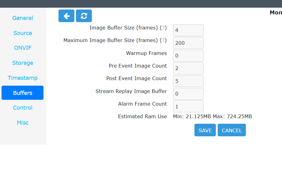

Next thing I tried was entering a number in the Maximum Image Buffer Size (frames), I read on the forums that suggested 121 so I tried that, didn't do anything so I bumped it to 150. May have helped but issue remained so I bumped it to 200. Seemed better but still getting the warnings.
Next thing I did was dumb luck because my recordings had like no pre frames, the alarm start was practically the start of the event. I set the Image Buffer Size (frames) the suggestion is 3-5 so I split went in the middle with 4. I then set my Pre Event Image Count to 2. This seemed to fix the issue and I have a smidge more frames before the alarm when viewing. It rained last night so my cameras have a ton of recordings and no warnings.. Happy camper!

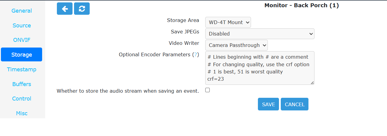

A little digging and I changed my Video Writer to passthrough and disabled the Save JPEGs. Seems to have worked and I have a lot more pre event images. I also understand that this setting is less taxing on the system to as it makes MP4s vs JPEGS.

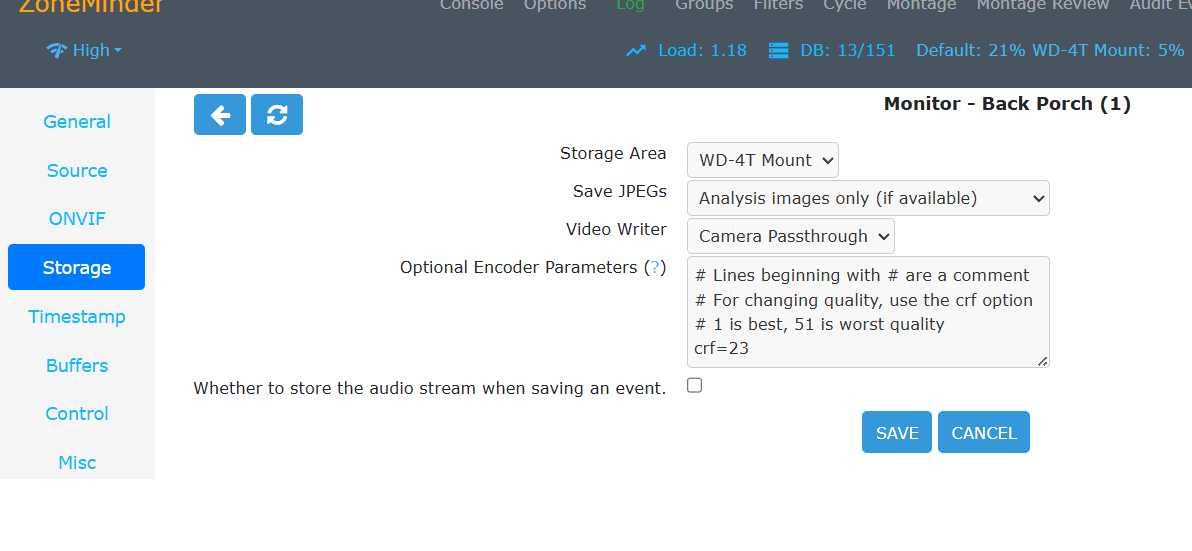

Oops, made a mistake.. setting the save JPEGs to disabled created a flood of new errors and warnings. I use MODECT so I'm analyzing, had to change that to Analysis image only (if available). Now things are looking better.. lol
