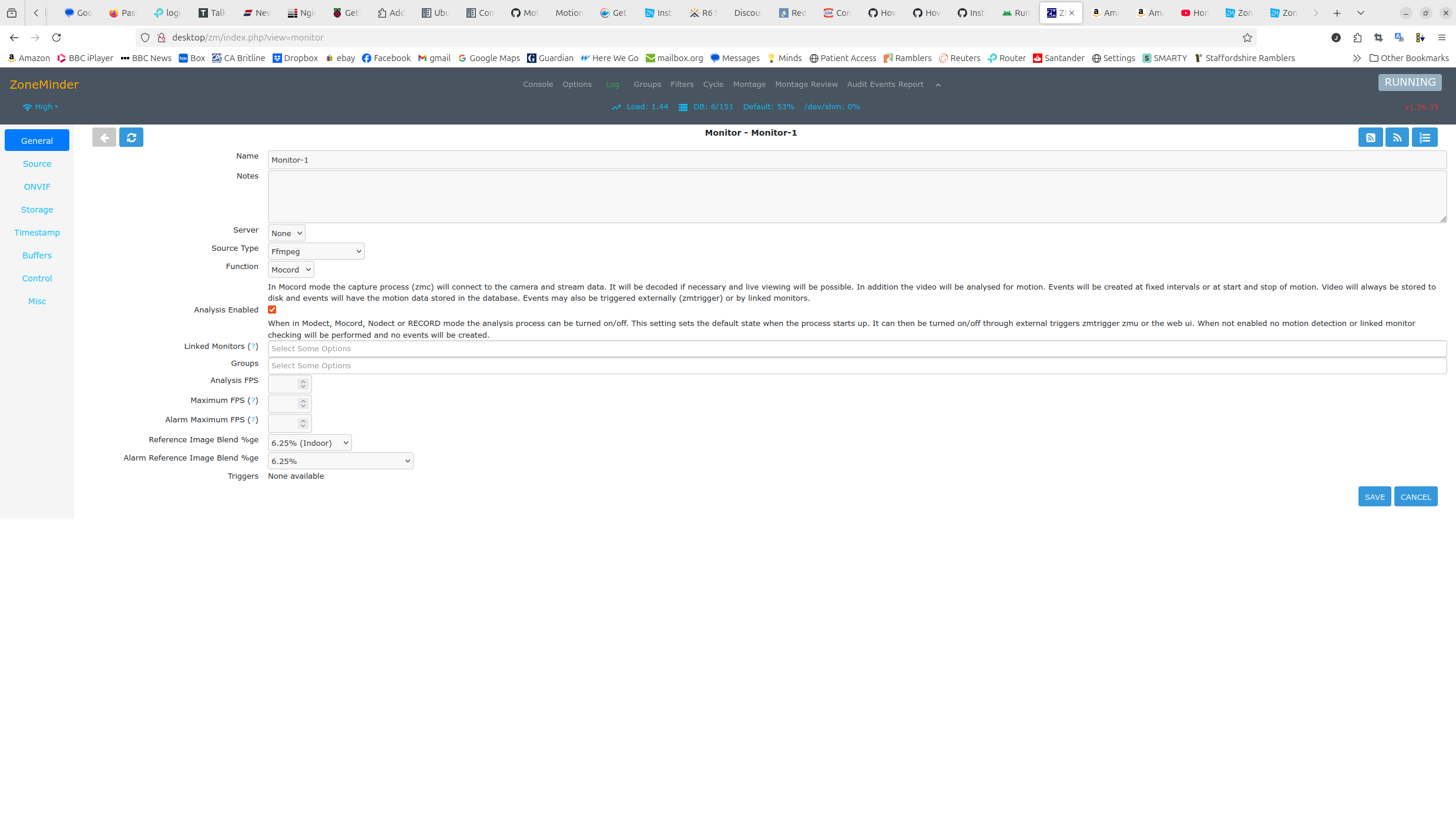

I have a TP-Link C310 camera. How do I add it to ZoneMinder?
I've attached a screenshot of ZoneMinder in my browser. It would help if someone told me what to fill in for each box.
PS what's the URL for ZoneMinder documentation?
How to add an ip camera?
