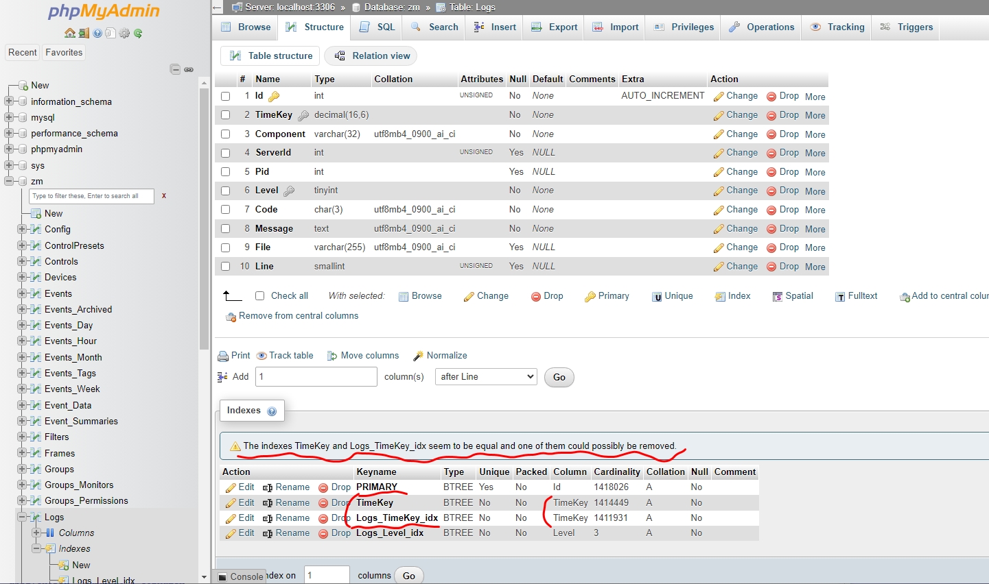

iconnor wrote: Sun Apr 07, 2024 2:40 pm I don't understand why you are asking to remove indexes
I made a mistake in my first message. There are two indexes "TimeKey" and "Logs_TimeKey_idx", they both index the column "TimeKey", why?

Posts: 3363
Re: MySQL Indexes of Logs table
THe only indexes should be as follows:
CREATE INDEX `Logs_TimeKey_idx` ON `Logs` (`TimeKey`);
CREATE INDEX `Logs_Level_idx` ON `Logs` (`Level`);
We can add more, but as I was saying mysql won't use them unless we also change the ORDER BY. What we probably need to do is REMOVE the sorting and let bootstrap-table do the sorting which I think it may do anyways... but then the pagination gets weird.

I wrote about this:
Or shouldn't it be like that?
Posts: 3363
It should not exist.
1.37.58 will remove it and add a component index.
