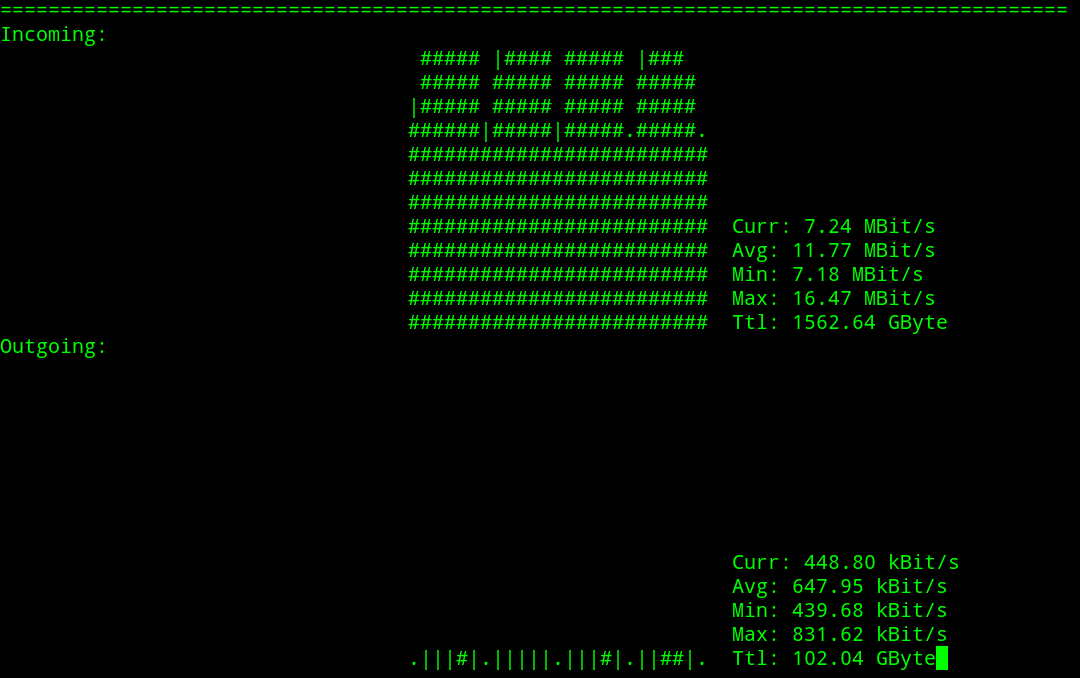

OK. Have you looked at the load into the server, byte-wise? Is it anywhere near the lan capacity?

I have checked the network bandwidth usage on the server and that does not appear to be a problem. Please see attached a screenshot of the output of nload with all 6 cameras streaming. I am not an expert in this area but for a 10/100/1000 gigabit NIC card that the machine has, the network load does not appear to be the bottleneck at all.
I have also checked zmwatch logs and can confirm there is nothing odd there.

- View of network load at full capacity
- nload.png (32.75 KiB) Viewed 14514 times
