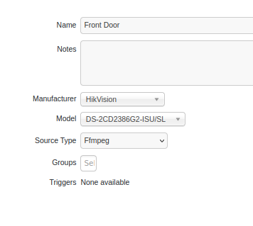

ffmpeg is configured for cuda on my system and the source type is set to ffmpeg.
Screenshot from 2023-03-20 20-48-11.png (14.31 KiB) Viewed 1761 times

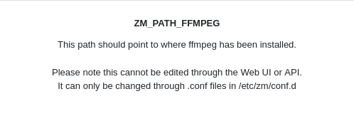

Did you see this?
Screenshot 2023-03-20 at 17-42-55 ZMX - Options.png (16.5 KiB) Viewed 1734 times
Isaac has stated elsewhere that using the hardware is kind of a wash because of how zm vs hardware works.
This may be an intermediate version as he looks to make it more efficient, or perhaps drop it altogether.
