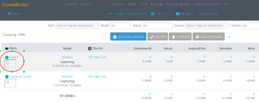

My Cam is now working but i can't see the display of this cam on the zoneminder console as you can see on the attachment.

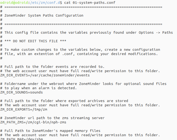

I've tried to change the PATH_ZMS and set /zm/cgi-bin/nph-zms as you can see in the attachment to.
I've tried many things to change the source, the mode, resolution.... but i can't fix it anyway.
I can see the streaming in rtsp and http with my navigator but i can't see it in zoneminder directly
Could you please help me because i don't know what can i do more, i spent lot of time to try a lot of differents things without succed.

Posts: 3363
Re: no camera streaming on Zoneminder
The problem is with your apache config.. The default apache config uses /usr/lib/cgi-bin but ZoneMinder's zms is in /usr/lib/zoneminder/cgi-bin.
ZoneMinder's default config for apache has a ScriptAlias line too, but they conflict.
Maybe try
sudo a2dissite 000-default
sudo systemctl reload apache2

iconnor wrote: Mon Oct 17, 2022 2:13 pm The problem is with your apache config.. The default apache config uses /usr/lib/cgi-bin but ZoneMinder's zms is in /usr/lib/zoneminder/cgi-bin.
Maybe try

mr.graf
Posts: 16
Joined: Wed Oct 28, 2015 3:39 pm
Location: Russia
Post by mr.graf »
Hello!
Unfortunately, I do not know what operating system you have. For example on Slackware Linux I build Zoneminder from the source code. When building, I specify where the files should be located. In the file with VirtualHost:
 DocumentRoot /var/www/htdocs/zm
    ScriptAlias /cgi-bin /var/www/cgi-bin
    <Directory /var/www/cgi-bin>
In the zm.conf file
# Path to ZoneMinder cgi files
ZM_PATH_CGI=/var/www/cgi-bin
and in the Zoneminder interface (Options-Servers-Path to ZMS) be sure to write the correct path to nph-zms (this is actually a link to zms). In my case it is /cgi-bin/nph-zms i.e. where ScriptAlias points.
It may be enough on zms, I have not tried, I have it since the earliest versions. :)
