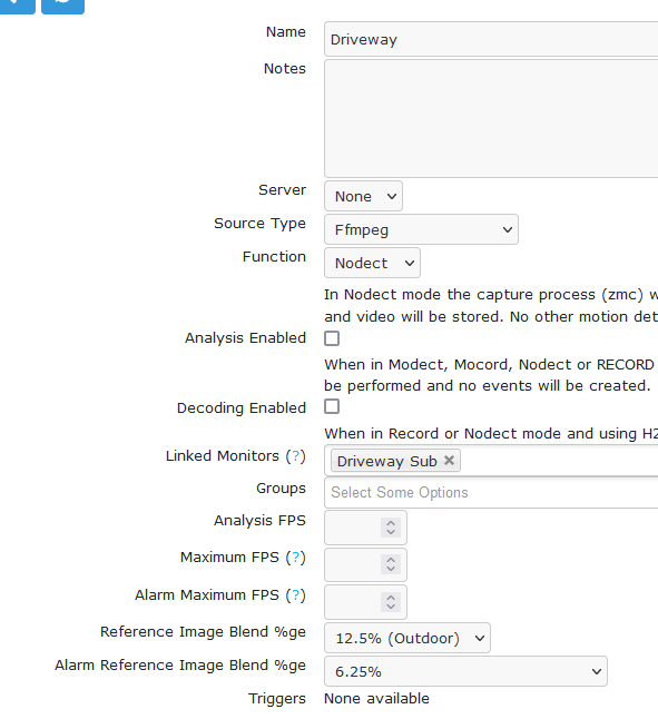

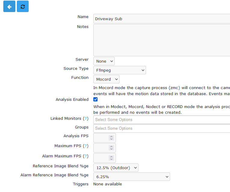

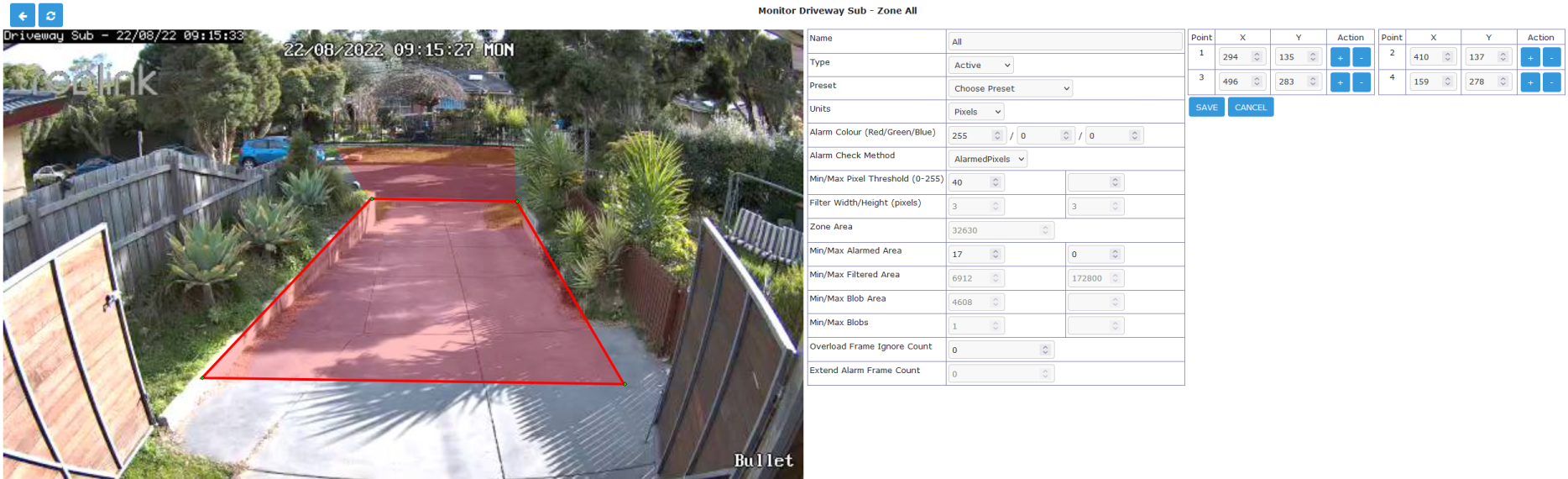

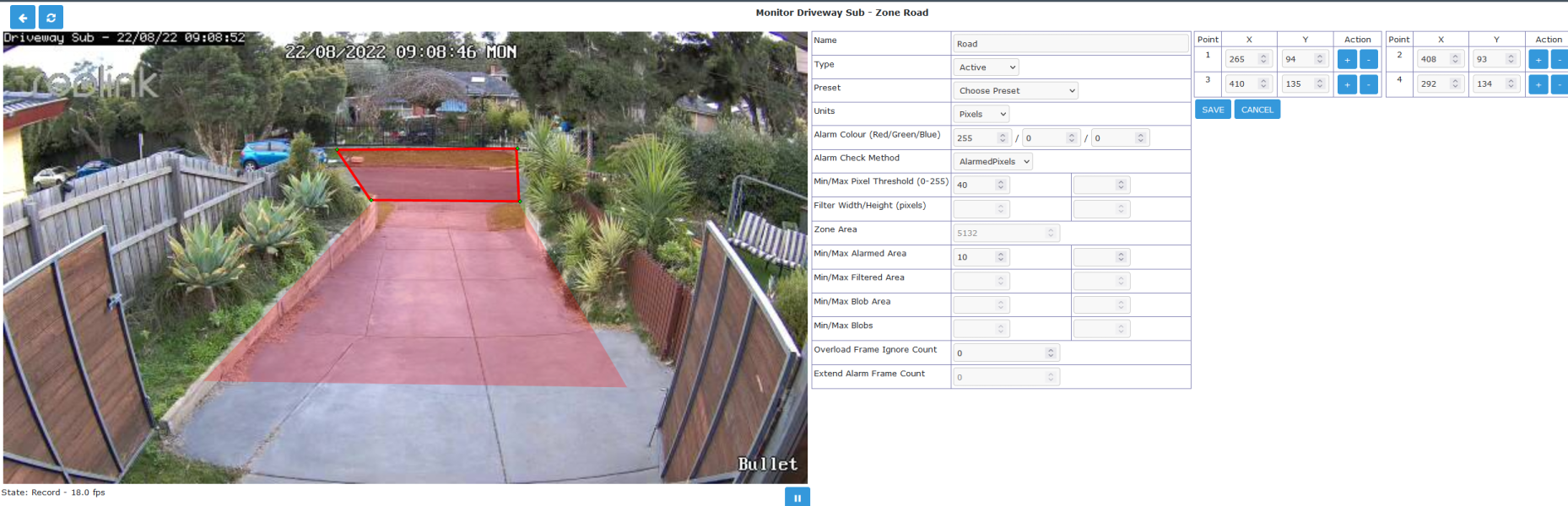

I have a setup for my RLC 811a whereby on the sub stream I have set it up on mocord and setup NODECT on the main stream where the substream is setup as a linked monitor. I have 2 zones defined for the substream and I have noticed that quite often, the main stream will record the tail end of the motion event.
I would like to understand how to fine tune so that I can catch the event from the start. Currently, for a lot of events eg. if an object is moving from right to left in the first zone (image 1), the event will be recorded when the object reaches towards the left edge of the zone. This happens for both for vehicles and pedestrians. Any advice how to go about fixing it?
Here are the zone settings for the 2 zones:

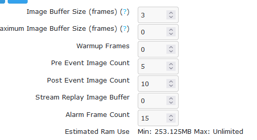

Other settings are as follows:

Settings for NODECT (Main stream) are:
