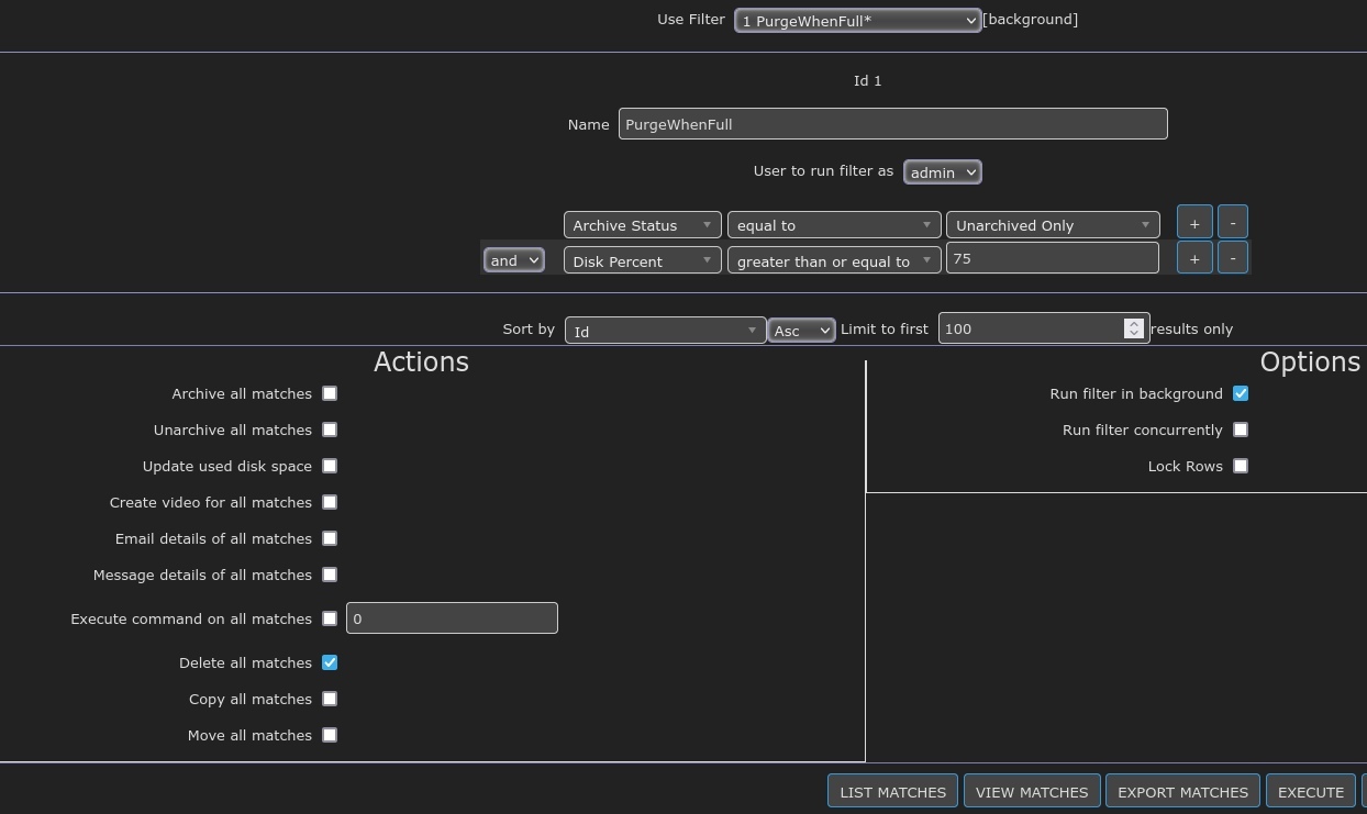

I notice there is a purge filter, which uses the 'delete all matches' and is run when disk is 75% full.
Will that leave the archived events alone or will it delete them?
If it leaves them alone, then if I create a filter which 'unarchives' and 'delete all' in the same filter, will that result in the archived items being deleted or will I be left with undeleted events?

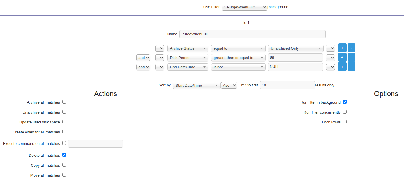

That has an unarchived only term, doesn’t it?
I’m pretty sure a filter will do what you tell it. You might get a warning when you save it, but you can ignore it if you choose.

No, the purge filter is as distributed, no unarchive.
...Lyall

Huh. I have not looked at the unvarnished dist lately...anyway, this is what they used to distribute:
So you can test to see if there's a built-in unarchived only. If so, you can probably just make a second filter to override it.
Screenshot from 2021-10-29 18-09-55.png (61.25 KiB) Viewed 2085 times

Slight difference. I just noticed the 'unarchived only' in the query clause, but I think my question still stands.
Does the filter delete archived events?
Will unarchive and delete work in the same operation?
These are not particularly clear, for example, in which order the checkboxes on the left are considered, top to bottom? I suspect not because delete is above copy.
So, in one filter I don't think I can Unarchive, create a video, copy and delete, all in one step. I would have to create multiple filters, then I have the possibility of filters interfering with each other.
