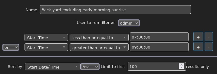

I am trying to create a filter in which I sort start date/time desc (newest one first).
Whenever I select 'Desc' in the dropdown and press Save, it quickly switches back to 'Asc'
Filter Creation Screen
ZoneMinder version v1.36.8 on Gentoo Linux using ebuild www-misc/zoneminder from oubliette repository.
PHP version 8.0.12, using MariaDB 10.5.10 back end and Apache 2.4.51
EDIT: Behaviour not present in v1.37.1

It appears, if I re-load the filter, it does indeed store the order in Desc, but will promptly display Asc, if I save the filter again.
