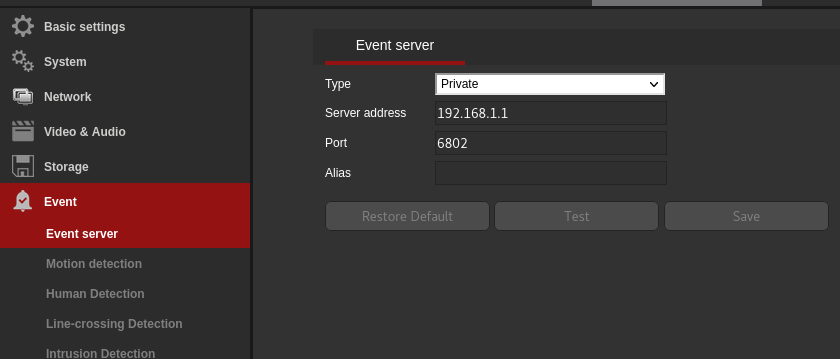

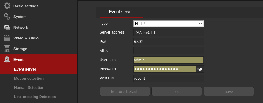

Re: Need help with nodect understanding
Also interested in these settings.
Now OPT_TRIGGERS enabled.
In Moniror Triggers are not available.
If select "nodect", nothing else appears.
what other settings do I need to make on the ZM side?
For "nodect" need Analysis Enabled?
my cameras with motion detector function. But I do not know which of the settings is better to apply in the event server. Screenshots are attached
