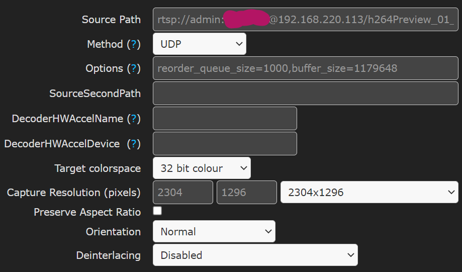

Hi @lk777 I've got two E1 Pro's, had lots of trouble getting them working until I got some help from the Dev here.
In the source for the camera, set to UDP and specify some extra settings for the Options:
These settings are much bigger than iconnor recommended me use, but they work very well for me.
I've also tweaked the default video sizing and framerate slightly but that didn't really make any difference, just helped reduce storage size a bit.
See screenshot attached for where to put these settings.
reorder_queue_size=1000,buffer_size=1179648
- e1_pro.png (41.79 KiB) Viewed 9609 times
Re: ZoneMinder Reolink E1 Pro camera issues
@Jay_from_NuZiland,
Perfect! It works now. Thank you so much!
