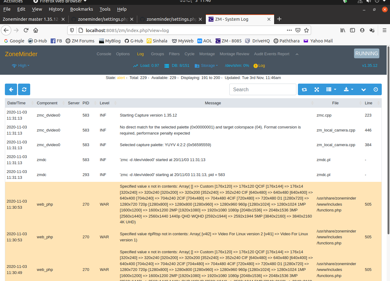

For the code at first link
log file is below
Screenshot from 2020-11-03 11-46-15.png (237.76 KiB) Viewed 2083 times

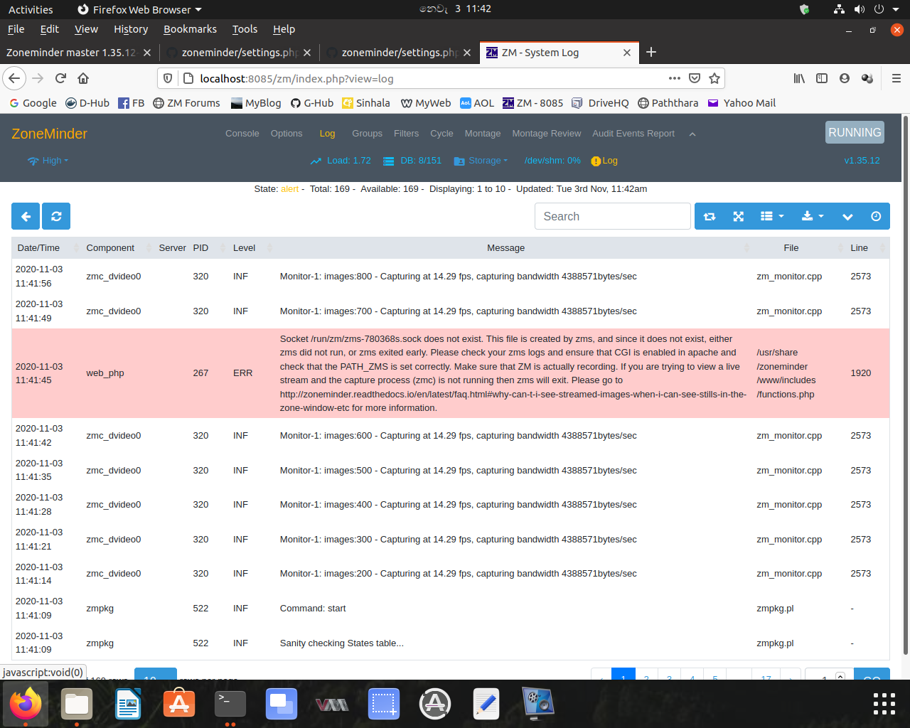

For the code at second link
log file is below
Screenshot from 2020-11-03 11-42-02.png (288.06 KiB) Viewed 2083 times
The brightness settings didn't work for both occasions

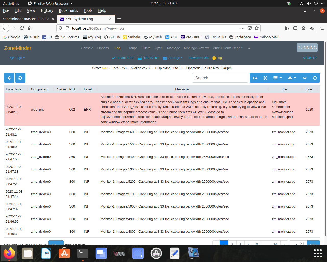

According to the first link there are no warnings in the log
For the second link when you change brightness and save there is an error indicated in the log as follows
Screenshot from 2020-11-03 21-48-28.png (291.3 KiB) Viewed 2043 times
The brightness can't be adjusted in both cases
