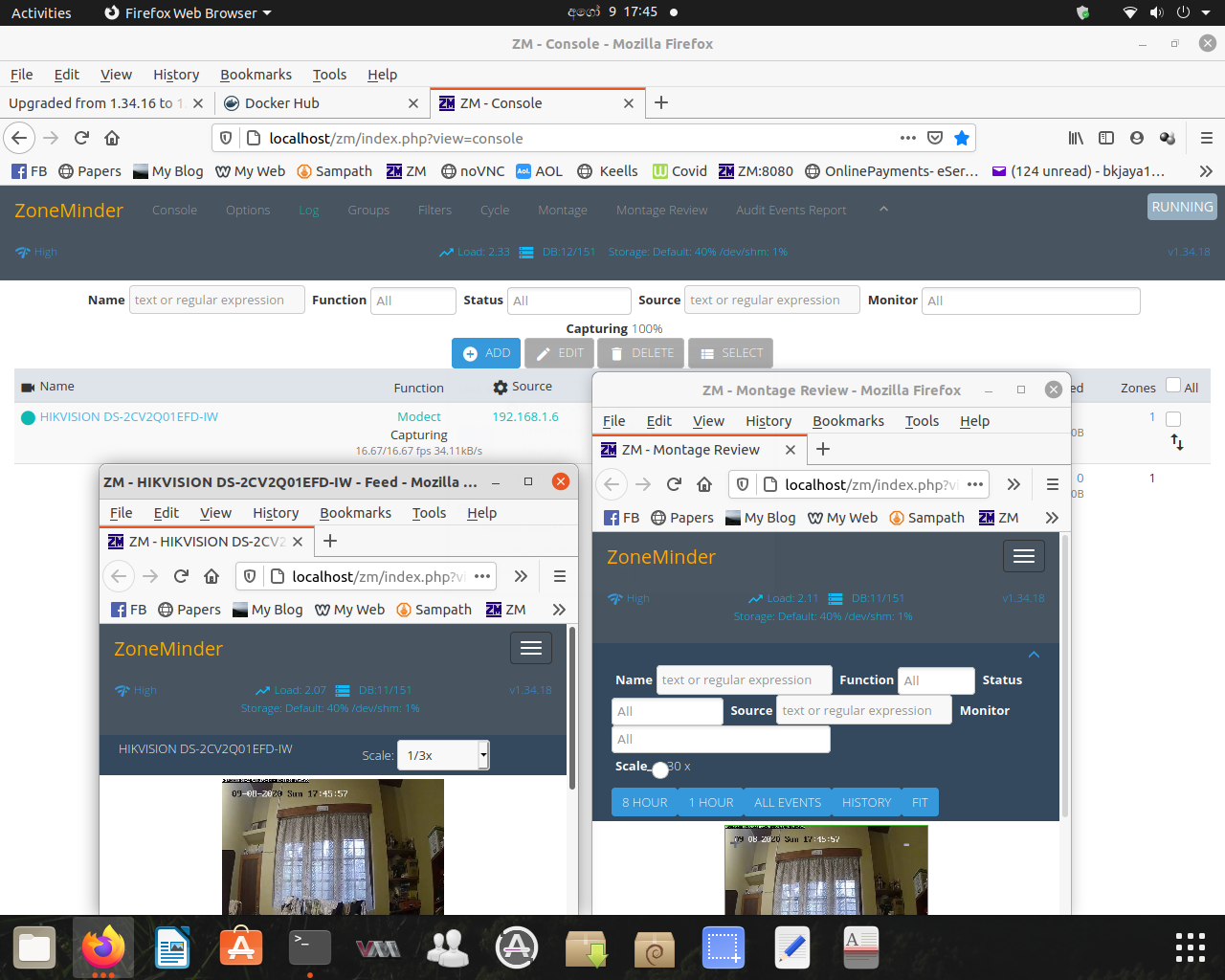

I have tested with fresh installation of Zoneminder 1.34.18 for a Hikvision IP camera and found views ,motion events , and montage review are working correctly .
Only problem that I have noticed is inability in adding usb camera monitors ( This problem has already been informed by a post )
Screenshot from 2020-08-09 17-45-59.png (394.95 KiB) Viewed 5337 times

I also have this issue with 1.34.18 as w00tl00ps and drkananga described, my cameras on Modect is working, but Mocord does not register any alerted frames.
Ubuntu 18.04.5 LTS
zoneminder 1.34.18-bionic1
