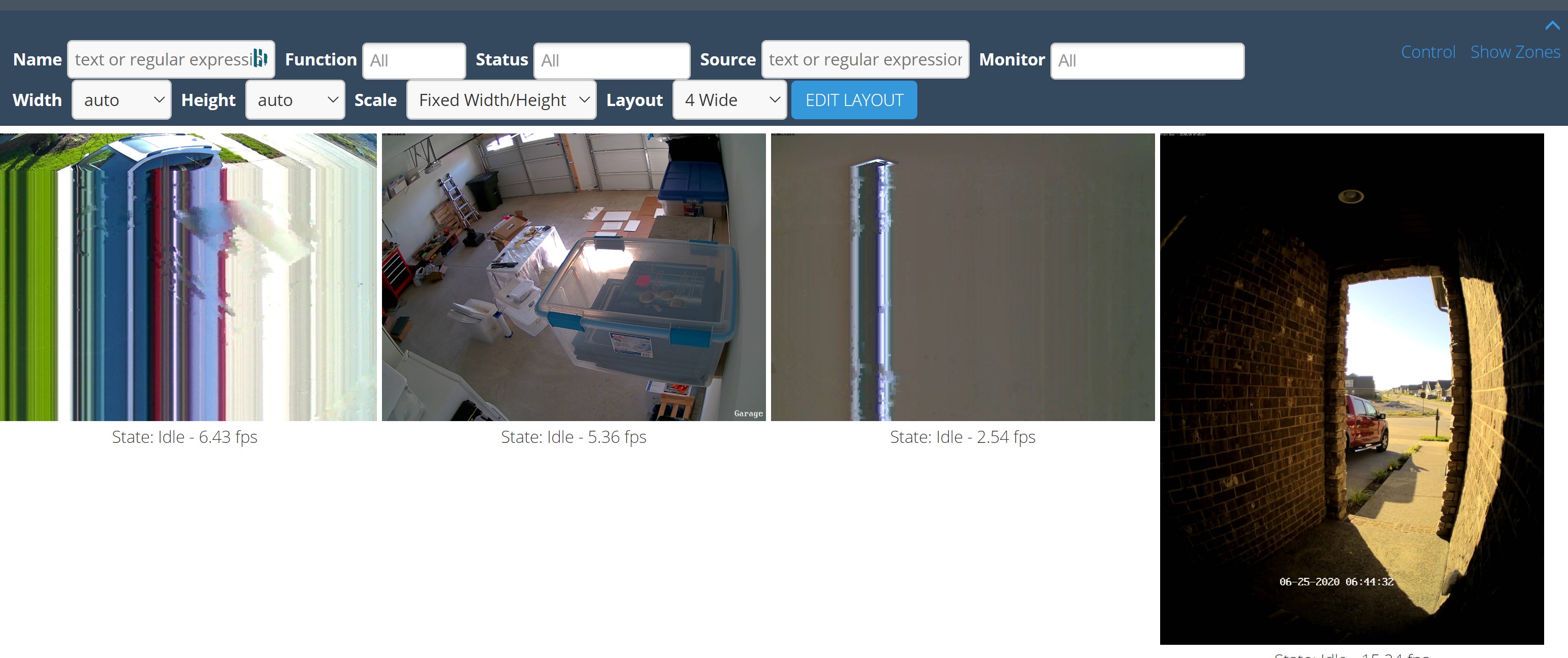

I have ZoneMinder running as a VM on a Dell R710 In XenServer. In the midst of my configs I just started throwing resources at it to see how it would respond. I'll likely take some resources away when I can get a good and stable config. Last night I think I made some better progress with lowering the frame rate. Here is what I have so far:
XenServer 20 cores running at 2.4Ghz with 36Gigs of memory
5 (2xreolink RLC-420 and 3xE1) cameras running 2560 x 1920 6fps and Image Buffer at 60
1 HikVision DS-HD1 camera running 1536 x 2048 with an Image Buffer at 65 (looking into the frame rate currently running ~15fps)

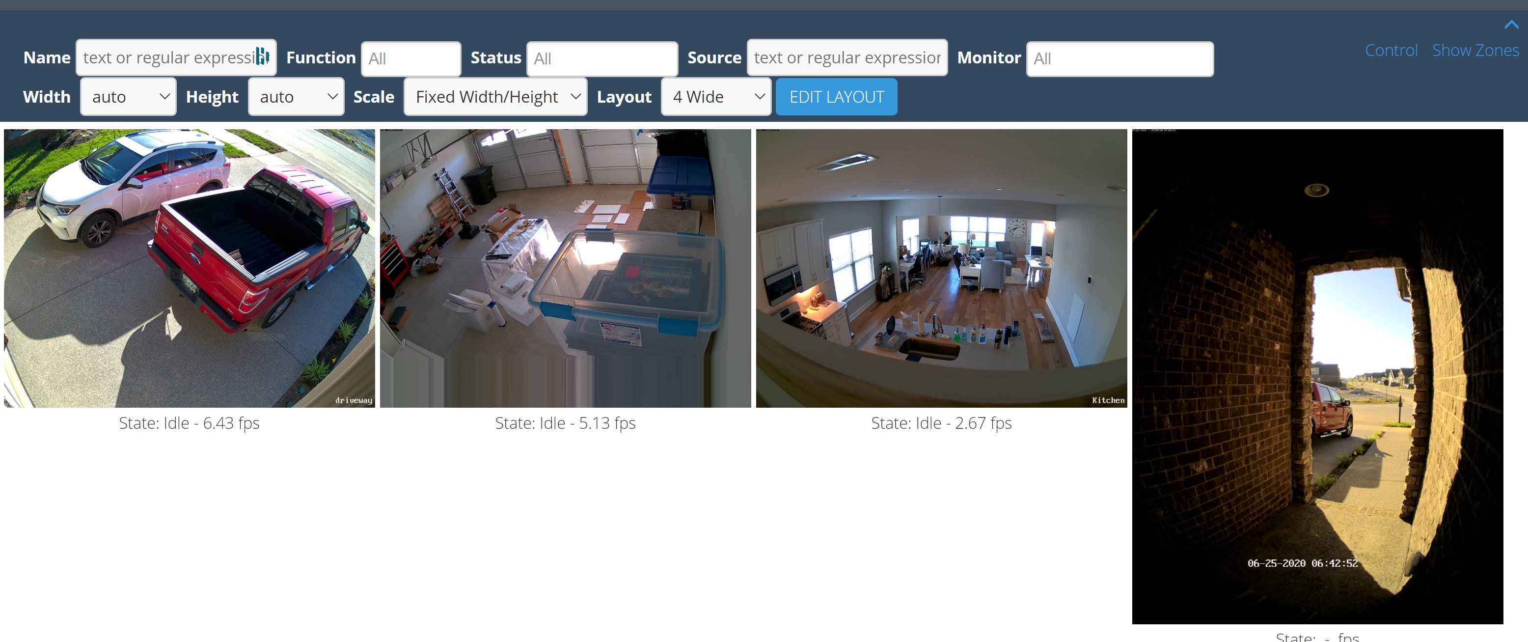

The doorbell camera has been working fine in Zoneminder. There are times where the others don't look right. When I reduced the frame rate the issue decreased in frequency and length however it still happens. I've attached a couple of screenshots. Are there more adustments that I need to make to the cameras? Or is this an issue with my setup in ZoneMinder?
Any help would be greatly appreciated!
