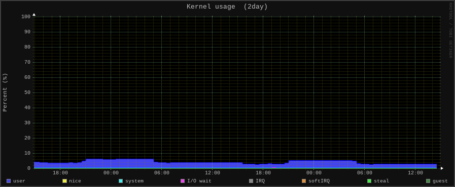

option 1. : 3MP stream, nodect linked to VGA stream modect. Alarms recorded: 3MP h264 camera passthrough, VGA analysis images only.
option 2. : only 3MP stream, modect, VGA monitor disabled. Alarms recorded: 3MP h264 camera passthrough.
Testing application: Monitorix - https://www.monitorix.org/
Tested on two consecutive days, almost same conditions (weather..), first day option 1., second day option 2. The result surprised me on a first look - no visible/notable load difference.
The second deliberation: ZM do so much, that motion detection on low or high resolution is a small part of a load produced.
option 1. - ZM must handle two streams
option 2. - ZM handles only one stream, the part of a load not to handle low res. stream is moved to motion detection on hi res.
So the result is about the same load of a system on either option. The critical (higher load) are nights, as you can see above.
So to offload, one stream option is better - smaller /dev//shm , events folder and SQL database occupation.
The developers could answer correctly, the above are just my observations and a test results.

I've found that the best performance is with Nodect, and external motion detection. There is a downside, however, that you have to setup the external motion detection.
In this case, you'd have the 3MP stream, and then Nodect on it.
