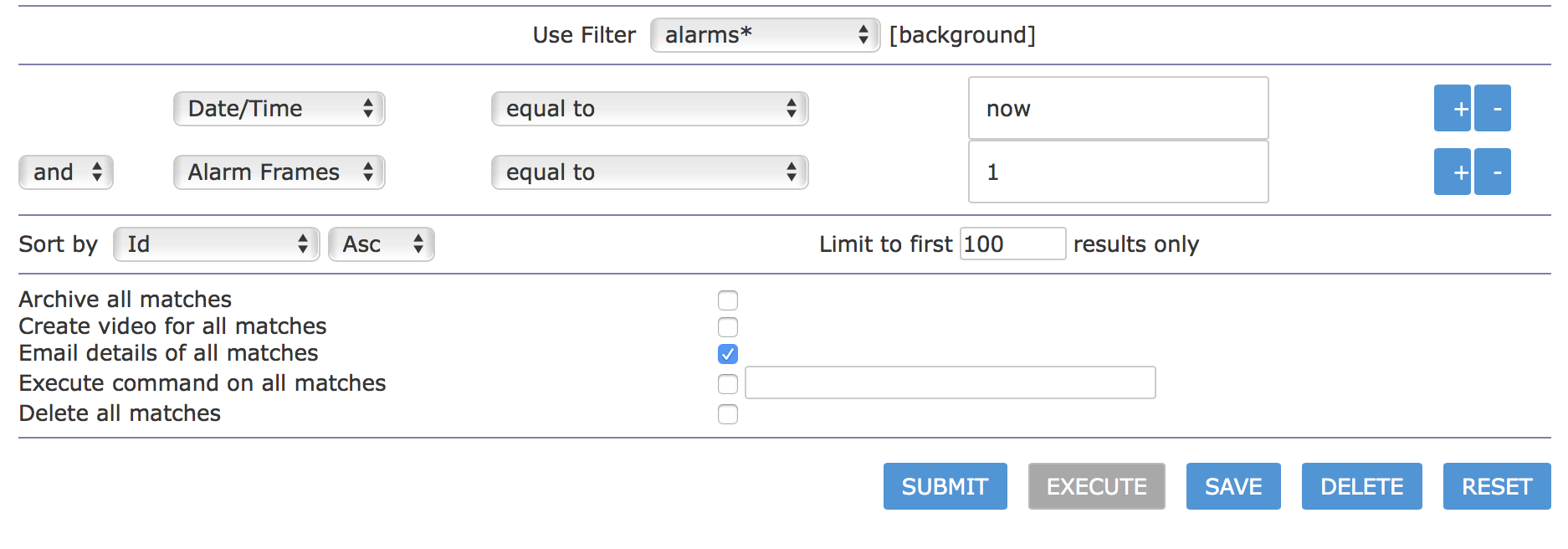

Ok thanks for everyone's help. So I am able to see how to create a filter, and save and run it in the background. But I'm having trouble with notifications. If I pull up the event list and click on show event filter from the top, I can execute the email to me. But on actual events, I am not getting email. Mine is setup as you see in the attachment. Is there something wrong with this setup to trigger and email upon the monitored area being triggered?

What do your logs say? (filter the logs using ""zmfilter") Hard to tell if it's the e-mail mechanics or your filter's logic.
The filter logic seems to have some issues. It is a bit narrow in scope in that it's only accepting a match of only a single alarmed frame. Perhaps make this "greater than or equal to" would help. Also, the Date/Time match is likely NOT going to work as the filter's run time is going to lag the event's trigger time: I use "greater than or equal to" "5 minutes ago" to manage any lagging (others can mess around to see what works best).

Thanks all. This setup seems to work. I thought I was saving the filer with the correct settings, but I guess not. This setup seems to work.
