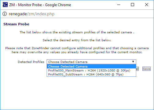

One thing I found playing with this camera is that ONVIF works but the camera has to have both a user name and password set. It would not work with "admin" and a blank password which is default.
rlc-410 probe.png (13.63 KiB) Viewed 281190 times

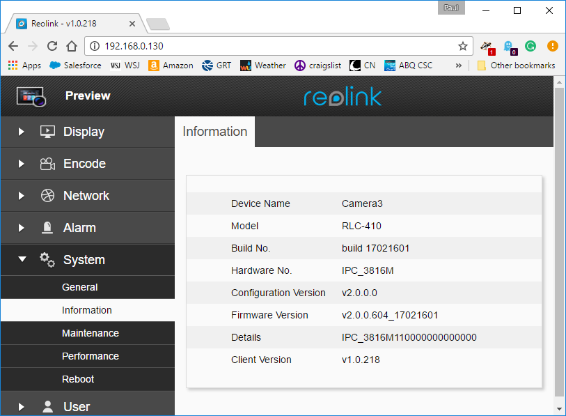

latest firmware
rlc-410 firmware.png (96.99 KiB) Viewed 281190 times
