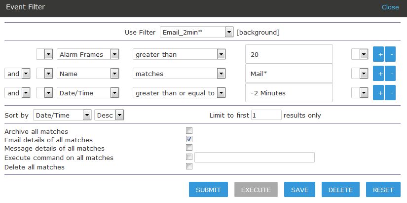

I installed Zoneminder 1.3 and it is working fine.
But i have somme issuses with filtering and sending emails on events.
I did the email setup as discribed in the Wiki and created a filter to send emails on alarm:
- Date/Time greater than or equal to -2 Minutes
- Sort by <Date/Time> <Desc>
- Limit to the <1> results only
- Email details of all matches <is selected>
The sript zmfilter.pl runs every 5 minutes.
And here ist the problem:
The filter as above selects allways the right event (the newest one, even it was sended by email or not) but i receive more than one email with different events.
That means the first email ist the correct one (with the selected event), but after the next run of zmfilter.pl (every 5 Minutes) i receive a new email which includes an older event.
It seems, that the script zmfilter.pl selects allways the newest event which has not been sended by email.
Any help to this?
Thanks in advance

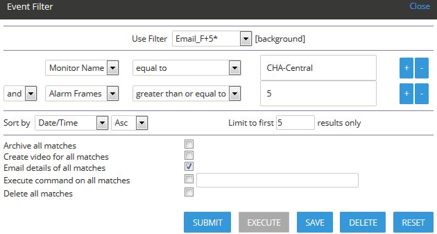

I've got this settings working just fine, if it can help...
Did you try to sort by <Asc> ?

Here are my settings, which works fine (shows the right event in zoneminder) but did not send the right event-data (as discribed in my first post).
Sorting by <Asc> will bring the oldest - not the newest - event.
rainer300
Joined: Tue Nov 08, 2016 12:41 pm
Re: issues with email filter
Post by rainer300 »
It seems that the zoneminder filter selects and displays the newest event in the web interface but for the step "Email details of all matches" the filter selects allways the newest event from the database which has not yet the "sent" flag (and of course that can be different events).
Any ideas?
Thanks.
