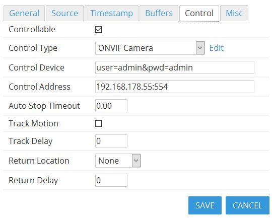

Hi all,
I bought a Sricam SP012 and get the video stream working, but I want to move it by using Zoneminder. Can someone give me a hint how I have to setup it in Zoneminder. I tried the following:
Many thanks in advance.
Frank

Try using ONVIF port 5000.
Could you please post your GENERAL and SOURCE settings?

as I'm only interested in how to move the camara - you can see, that the stream is working fine in ZM.
My settings are:
Quelltype: Ffmpeg
Quellenpfad: rtsp://user:password@192.168.178.55/onvif1
Remote Methode: RTP/Unicast
It is running on ubunut 16.04. Maybe you should check if ffmpeg is installed.
Best regards
Frank

Thanks guys !! i been trying for a couple days to get this sricam working, I have a SP005 ( i guess because its not marked ) and i only got that from the Q&A on the amazon where someone asked. I have video now! so the the largest thing, but would be nice to get the ptz working. I found the options to enable control, i mimicked the setting above and tried both ports, i did a namp and that the only to ports i see open. the cam does function properly with the phone app. any other tips on how to get the controls working ?
