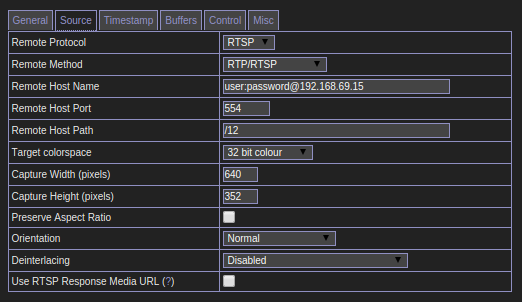

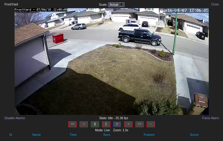

Ok so after days of ripping my hair out and moving over to try to get ONVIF working I got a config that gets me seeing the camera in ZM. I'll post to the wiki for this camera once I have everything worked out but I do see video so I'm stoked.
The high level was I abandoned Ubuntu's libav and compiled ffmpeg from scratch, then built ZM. Not sure if this was needed but I figured I may as well start right from scratch and included ONVIF support.
Next I messed around with zmonvif-probe.pl until I finally got some kind of response (still issues here but it got me in the right direction). What eventually got me some hints was scraping for profiles:
# zmonvif-probe.pl -v profiles http://192.168.69.15:8080 USER USER_PASS
snip ----8<---
MainProfileToken, MainProfile, H264, 1920, 1080, 30, rtsp://192.168.69.15:554/11
SubProfileToken, SubProfile, H264, 640, 352, 25, rtsp://192.168.69.15:554/12
----8<---- snip
So I finally had an idea on what to hit, I just needed to create the monitor. To create the monitor, My settings are:
I went with the second image for now rather than going for the higher resolution image. All this being said I'm getting quite a few errors in ZM while I'm seeing the video but I'll post that as a different issue. The initial issue of not being able to see the camera in ZM has been resolved!! :D

I have a HW0045, I use the onvif connection and it gives very good image. The formula is : rtsp://user:login@ip address:554/11
