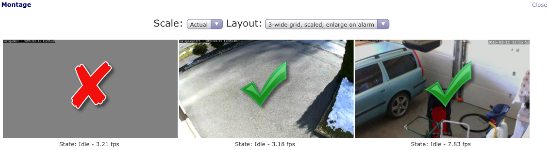

I have trouble with ZM - after some hours (stretching randomly from a few hours up to more than a whole day) of successful running some cameras start to show a 100% grey image. Hitting the Save button in ZM's settings for that monitor (without making any changes) refreshes the image for some additional hours.
ZM montage
ZM montage

When viewing the cameras, the ACTi image sometimes (rather seldom) briefly flicker to 100% grey and quickly back to normal. I have not managed to find out if this glitch is fed from the camera, or "invented" in the zmc capturing or later.

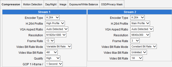

Do you think its any idea to tune the camera compression settings or try MJPEG instead of H.264?
Video settings in ACTi D72A camera
2016-03-17 07-37-34.png (19.83 KiB) Viewed 17265 times
I'm capturing off stream 2 (H.264 Main Profile, 640x360, 3 fps, constant bit rate 1Mbit). As you can see on the hi-res stream there are additional settings available when going for variable bit rate, e.g. the I-frame interval can be chosen between 1, 2, 3, 4 and 5 seconds).

But as a test I changed from "fixed bitrate / H.264 Baseline" to "variable bitrate high quality / H.264 Main Profile" on my second camera (still keeping it as remote) before the weekend and it has been running since then with only occasional decoding issues in the log, monitor still running. Also the first camera (still on ffmpeg and fixed bitrate since my failure with trying libvlc on Thursday) has run without issues since over the weekend.
Variable bit rate / high quality has increased the network and CPU load somewhat, but capturing seem to have less issues with less compression in camera 2? I'm now reducing the compression on the first camera (on ffmpeg) as well to see where it takes me.

Update: I've run both my ACTi cameras on variable bitrate / high quality / H.264 Main Profile for more than 10 days now without a glitch... :D
The log is also much more calm now; no decoding errors.
