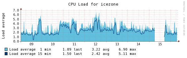

My current specs:
Core i7-3770 quad core 3.4GHz
16G memory
4x WD 2TB drives set up as RAID5
Scientific Linux 6.5
4x IP cameras putting out 1920x1080 video
3x Analog cameras being pulled off a remote system, 640x480
The IP cameras and the zoneminder system are all plugged into a POE switch, so the camera network traffic is mostly isolated from the rest of my network.
Here's a graph of the load average over the last week on the zoneminder system. Mostly under 2.0
I got a couple more cameras to get mounted and hooked in, but from what I see so far, it looks like I shouldn't run into any issues just by added two more IP cameras.
- Load average over the last week.
- zm-loadavg.png (37.16 KiB) Viewed 3457 times
