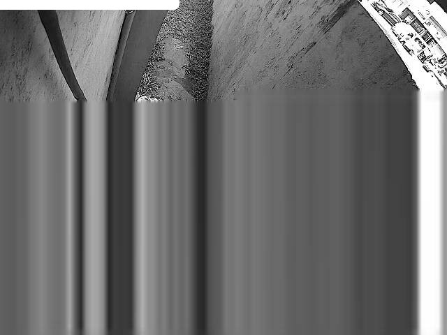

one of my sites runs on a Debian Wheezy with a self-compiled v1.26.3. It actually aggregates up to 10 PLANET cameras via RTSP/H.264 at two different sets of resolutions (640x480 + 800x592 @ 10/15 fps). I've described the way cameras are configured within ZM using the following wiki page:
http://www.zoneminder.com/wiki/index.php?title=PLANET

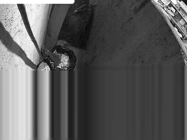

Back to my initial problem - I'm facing destortion and image artifacts, occurring more or less frequently. See the attached images.
For clarification:
  • No RFI/EMI, cables used for installation all of CAT 6a (SSTP)
  • The entire setup is grounded so no interference from that side neither
  • No Power Fluctuations since the setup is powered using a UPS which also serves as an AVR
  • ZoneMinder Instance is a "far-end" system connected via a fiber optical link (fully routed)
Unfortunately I don't have any cameras in spare just for the sake of testing it locally at my office.
Some additional thoughts: Sometimes cameras are opting out just like that requiring a hard reset. I'm trying to handle this using PoE monitoring implemented by the switch powering the cameras. Just as of now the feature is still buggy as hell but also only breaks it down to the network level using ICMP echo probes. So if the web server becomes unresponsive leaving the camera reachable via ICMP, the reset won't happen. Well, funny thing is that it also happened with the firmware versions before.
To me it looks more like an issue that might require some tuning on the side of ffmpeg/avconv?
Any ideas? Experience? Suggestions?

During day time distortion doesn't seem to occur that much often. But maybe it's connected to the fact that right now three cameras are down leaving only six active (five in mode monitor and just one in modect). The ZM instance is running on a virtual host with 4 VCPUs and 8GB virtual memory.

Same issue as in quite a few others threads on page 1+2. Usually occurs in low-light scenarios and with h264 sources through ffmpeg. You could switch the source to mjpeg (through ffmpeg) and that would solve the issue yet has its downsides.
You could also check your monitors rate limit (fps), happens with logitech alert when fps is set to <5.

In my case it seems to happen only in low-light scenarios. I think fragmentation should occur persistently and not based on the time of day.

Here's something I observed. When limiting the frame rate within the monitor configuration by means of setting maximum fps to less than the actual rate that's provided by the camera, the distortion is nearly persistent.
Basildane
Posts: 120
Joined: Mon Sep 16, 2013 1:09 pm
Re: Distortion of RTSP/H.264 Stream Messing Up Modect
Post by Basildane »
Correct. If the camera is pushing a certain frame rate, you cannot ingest it in zm at a lower rate.
You must lower the rate at the camera.
