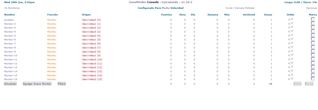

I have a 4400 Kodicom card with 4 bt878 chip, the problem is that ZoneMinder version 1.24.2 does not recognize the cameras installed.
In /etc/modprobe.d/bttv.conf I have the following configuration.
~ $ More / etc / modprobe.d / bttv.conf
gbuffers options bttv card = 133,132,133,133 = 16
bb99
Posts: 943
Re: Kodicom 4400
Post by bb99 »
ZM doesn't deal with the camera's at all when you have a capture card interface. ZM deals with the card only and the card with the camera's. First thing to do id set all your functions to none except one (use /dev/video0 channel 0). Once you get it working, all other camera's on the chip be configured exactly the same. For your source tab use: /dev/video0, channel 0, grey scale (gray), 320*240 (for NTSC). If this doesn't help out then you will need to post all your monitor settings and whether or not you're using mmap or shared memory config.
