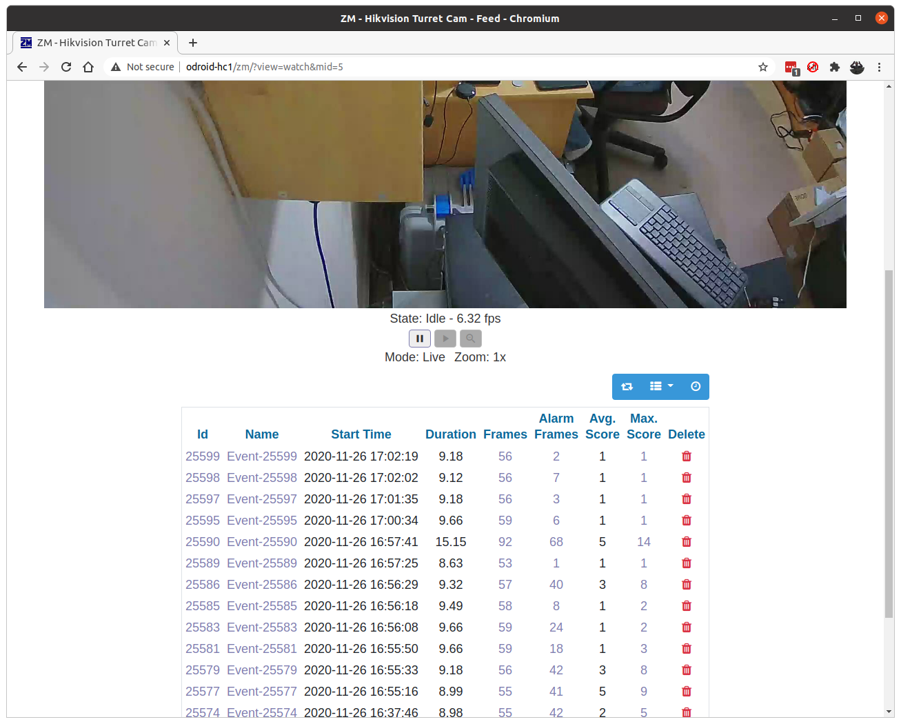

The event table at the bottom of watch view has been converted to a bootstrap table.
Here are the relevant changes:
  • auto refresh cane be paused by clicking the clock icon
  • table data can be manually refreshed by clicking the table refresh button (refreshes table data only. does not reload the page)
  • clicking the delete button presents a confirmation modal... no more accidental deletes
  • column names have been made consistent with the events view

Posts: 1377
Re: ALERT - Major UI Changes - Work in Progress
This works nicely on desktop, but on iPhone with chrome and ff, ID, Name and part of start time is cut off.
Thanks for the feedback. I'll see what I can do.
As a workaround, you can hide columns of your choosing from the toolbar just above the table. Try turning off a couple of the frames or score columns. That should let table fit properly on the screen.
@dougmccrary question for you. Does the table in Events view behave the same way on your mobile device?
Posts: 1377
Yes, either way it's cut off on the left - seems to think the view is wider than it is.
Removing columns helps, but still cuts off with just a few columns active.
dougmccrary wrote: Sun Nov 29, 2020 11:19 pm Yes, either way it's cut off on the left - seems to think the view is wider than it is.
I set the responsive table class with a small screen breakpoint for watch and events view:
https://github.com/ZoneMinder/zoneminde ... 6b39e7a283
This should let you scroll the table horizontally from your mobile device, when it is wider than your screen.
Please let me know if this fixes the issue, so I know to propagate these changes to the other bootstrap tables.
Posts: 1377
Yes, that works.
Thanks!
