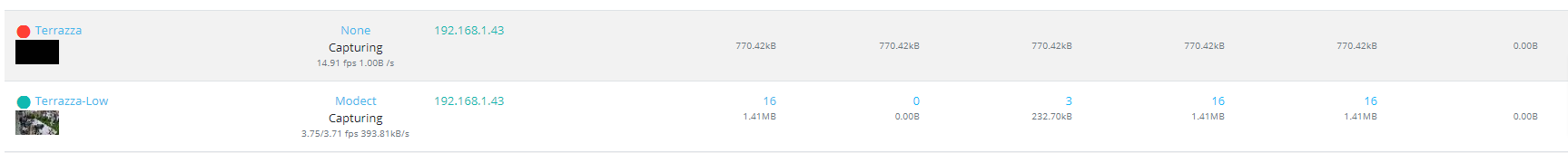

xefil
Posts: 53
Joined: Wed Jul 19, 2017 1:30 pm
Re: Record High-res H264 streams 24/7 with low CPU Load
Post by xefil »
Goood morning bbarnett,
You mean download latest gzip from github (I've used this https://gist.github.com/mwvent/f4d30599 ... readme-txt) or yours? Yours are only single patches, right? Or do you have a single download file as well?
Ok for the linked monitor function, but seems not working properly in my case. I don't know if due my version (possible) or patches applied wrong.
WAIT: I've found an Alarm Frame Rate set on value "1" on a recorded stream for an event occured on the low-res MoDect, so is that the expected behaviour?
I'll try the original ones as well asap. For now, This is my console:
You can notice there are no clickable records on the high-res monitor recorded by the script. BTW if I search for them into filters, they are there, clickable and can be shown without issues.
Thanks, Simon
EDIT01:
Found alarm frame, mentioned above
EDIT02:
I've noticed the Monitor_Status was with all event counts set to `(NULL)`. I've tried to stop zm and the script, rewritten all `(NULL)` to `0` and restarted both zm and your script. At the first look, the counters started correctly, setting a first event to `1` with correct size and bandwidth, but some minutes later, back to `(NULL)`. Seems that zm is overwriting those values? But it happens only to the record with monitorid used by your script.

Hello bbarnett again!
Found the issue, maybe.
I've replaced:
 SQL="   REPLACE INTO Monitor_Status (MonitorId, Status, CaptureFPS, CaptureBandwidth)
                VALUES
                ('$MONITOR_ID','$STATUS', '$FPS', ${LAST_BW:-0})"
with
SQL="UPDATE Monitor_Status SET Status='$STATUS', CaptureFPS='$FPS', CaptureBandwidth=${LAST_BW:-0} WHERE MonitorId='$MONITOR_ID'";
and it works correctly. AFAIK the `REPLACE` makes a delete and insert.
ZM does following updates on an monitor, i.e. having id 13:
UPDATE Monitor_Status SET CaptureFPS = 25.17, CaptureBandwidth=77448 WHERE MonitorId=13
INSERT INTO Monitor_Status (MonitorId,AnalysisFPS) VALUES (13, 24.96) ON DUPLICATE KEY UPDATE AnalysisFPS = 24.96
I'll have to reset the whole history maybe, but not so bad.
Hope that helps!
