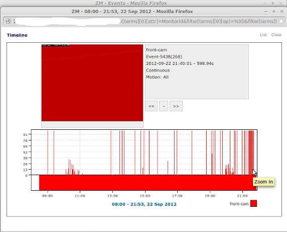

One thing I'm noticing is that when I go to a Timeline view and there is an event, if I mouse-over it, the preview is RED but an event with no alarm previews fine.
- screen.jpg (93 KiB) Viewed 10100 times

Re: ZM 1.25.0 Performance Patch - Completed
mastertheknife:
any clue as to why it goes red???? How do we roll back (thats what I want to do)?
Reinstall the good version?
