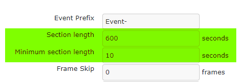

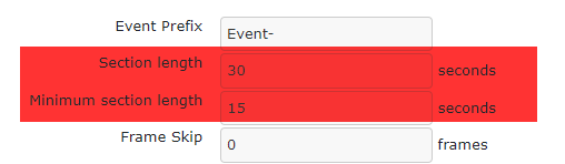

fontiano
Posts: 68
Joined: Wed Dec 25, 2019 10:29 am
I have identified the problem
Post by fontiano »
I need the recording to be divided into 30 second sections because I have to post-analyze the videos that have alarmed frames. With this setting the memory filling problem occurs.
With the default parameters instead it seems that the system is stable but it is not suitable for my needs.
As I wrote earlier with version 1.34.X it doesn't happen
Production: zm 1.34.26 - Debian 11 | Test: zm 1.36.33 - Debian 12

"General" section
Function: Mocord
Analysis Enabled: true
"Misc" section
Section length 30
Minimum section lenght 15
