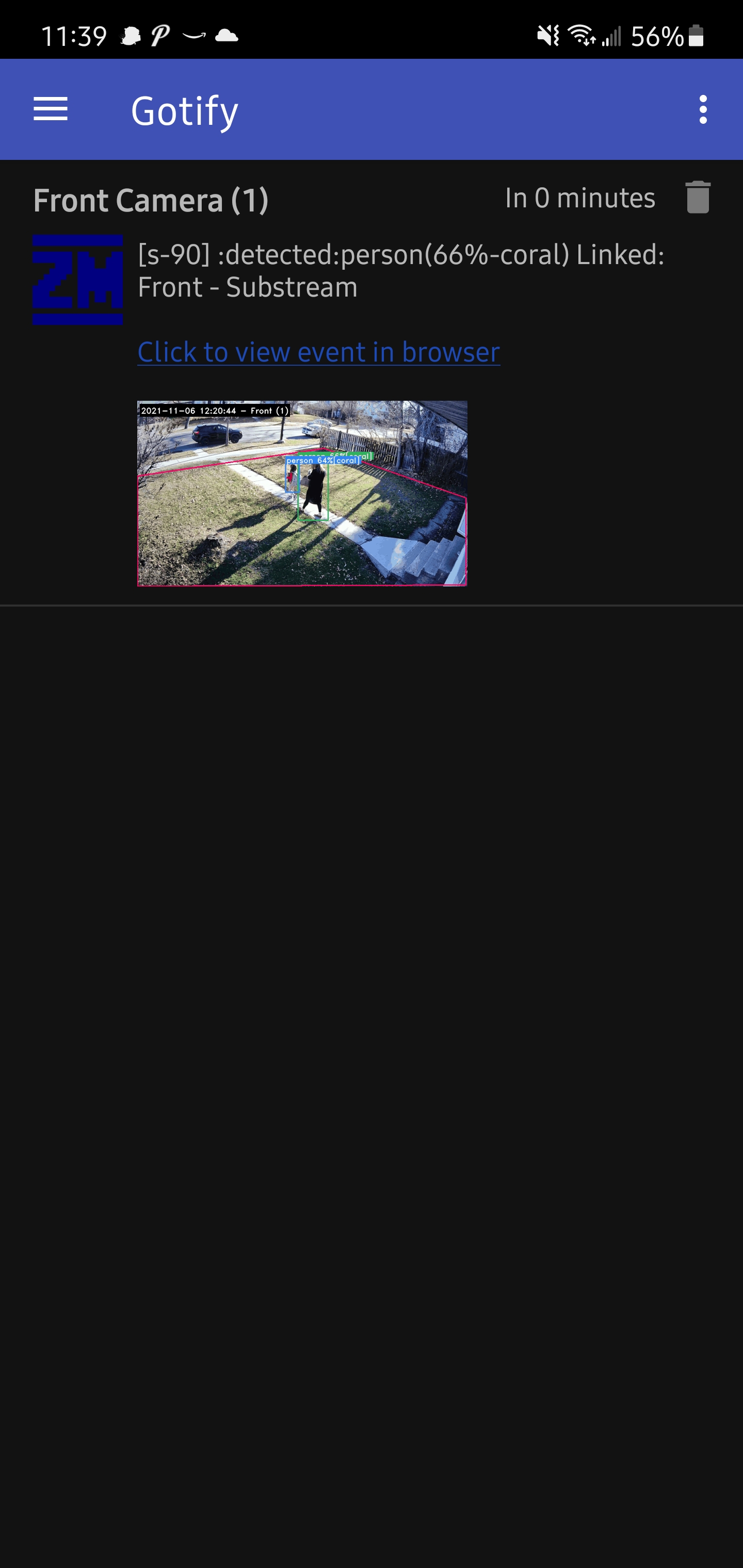

juan11perez wrote: Tue Nov 09, 2021 11:58 am for gotify I use the ZM TOKEN and I renew it every 3 hours. So I would use that.
Have you gotten the clickable notification URL to work? No kidding I have spent the last day trying to get it to work. Better option I guess is to just have a link in the message of the body to click.
Im pushing last few things right away and then ill be testing install. I added a pyzm install script to mlapi repos, I added effeiceintdetv3 lite and mobilenet v2 TF2 models when the install scripts grab the tpu models.
The custom push script option I am adding will send the ZM_TOKEN along with the usual args to the bash script, so you wont have to patch together something to get a token yourself. Its configurable in the objectconfig file. The push_user and push_pass options will be used to grab a token if they are configured, if not, the ZM_TOKEN will be the ZM_USER token.
# Arguments passed
# ARG1 = event ID
# ARG2 = monitor ID
# ARG3 = monitor name
# ARG4 = Alarm cause
# ARG5 = type of event (event_start or event_end)
# ARG6 is the AUTH token (the token starts with 'token=', so dont put token= before ${ZM_TOKEN})
# ARG7 is the path to the image (Optional)
# If you configured push_user and push_pass in objectconfig then the token will be for that user.
# If you did not configure push_user it will pass you the configured ZM_USER token instead.
# I reccomend making a ZM API user with VIEW privileges and using that for push_user and push_pass.
This allows it to be modified to send to whatever push notification service. I am really impressed with the speed of gotify notifications. The web app plays GIFS, the android app isn't so great but it gets the job done.
The performance I'm talking about was hardcoded into the logic of how zmes handled things and the metrics I'm going for are total time for detections (using most as the strategy for both frame and same model sequence strategies and with image creation/labeling, push and mqtt notifications).
Logging into the ZM API and grabbing an AUTH JWT took 0.8-1.2 seconds for me on average. Before, the script would sit and wait until the API returned the token and then it would go on about doing other things. Now, it creates the API and logs in, in the background and does as much as it can before waiting for the API to return some requested data it needs before it can do anything further. I am optimizing this system as we speak to make things even faster (which means testing all sorts of scenarios and ways to optimize them).
Animations are still slow, I threaded the function that creates them but I can only do so much due to needing to wait for the matching image to be identified.
Edit: With the gotify web app you can embed the events right into the notification!!! It does not work on the android app but the web app works great, web app also plays GIF and I imagine mp4 as well (browser dependant?)
      \"message\": \"${MESSAGE^}\n![Embed the event right into the notification](${ZM_PORTAL}/cgi-bin/nph-zms?mode=jpeg&frame=1&replay=none&source=event&event=${EVENT_ID}&connkey=77493&${ZM_TOKEN})\n ![Camera Image](${ZM_PORTAL}/index.php?view=image&eid=${EVENT_ID}&fid=objdetect&popup=1&${ZM_TOKEN})\",
I have instead created a clickable link inside of the notification above the image. It is like the Pushover notification now! Pushover has the custom notification sounds though which I've come to really enjoy. I get 'motion detected in the front yard' when anything but a person was detected in the front yard. When a person is detected in the front yard I get a 'person detected in the front yard' sound along with my pushover notification. Super handy!

For gotify yes (clickable notification URL) works. but dont click on the expand arrow on the right. when you get the notification, touch the tittle section. For me it opens a webrowser with the zm url to the video/event and it just plays it.
Yes gotify is faster than any other. You're hosting yourself and there's no throttling. It has some limitations, but it more than suffices for this purpose.
I dont really understand the benefit of the animation, if I can click on the notification and see the event video. Maybe I'm missing something.
