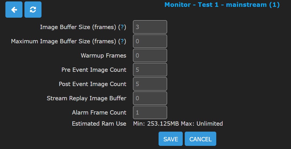

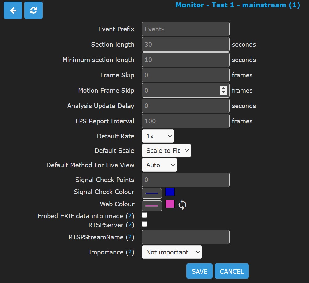

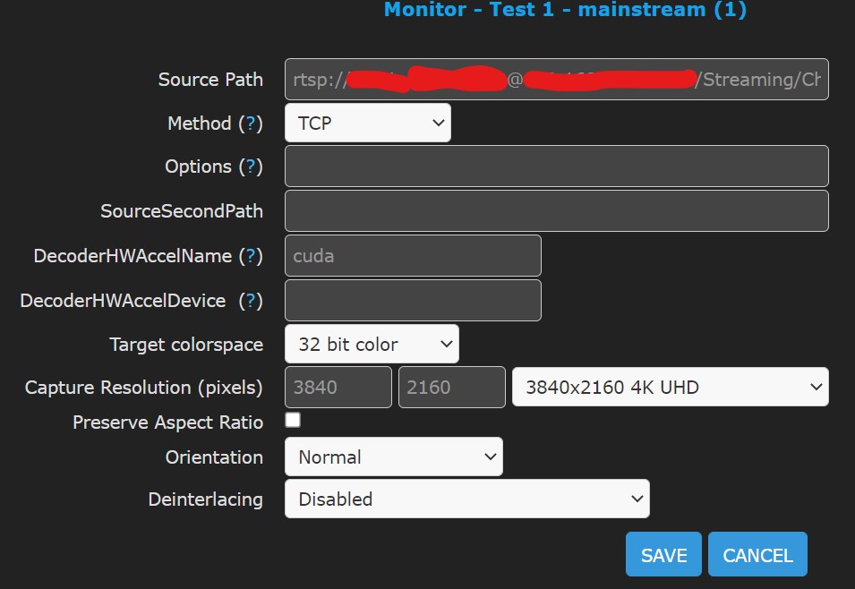

4. Screenshot Monitor Source, Buffers and Misc menu pages

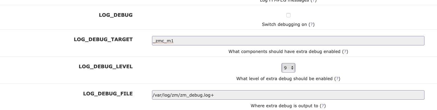

Ok here's what I did. I checked 'switch debug logging on', entered '_zmc_m1' into the box 'LOG_DEBUG_TARGET', then saved. Then I set the monitor from 'monitor' to 'record'. Then I left it running for 2 minutes. Then I switched it from 'record' to 'monitor' again, then unticked 'switch debug logging on', and erased '_zmc_m1' and saved. Then I stopped the Zoneminder container, opened the logs, selected all, and pasted it here:
https://pastebin.com/4bDmvtxH
See attached.

Remove DecoderHWAccelName = Cuda from Monitor as that is only throwing an error. Not the one stopping it working but still something less to clutter logs.

SteveGilvarry wrote: Sun Jul 18, 2021 1:37 pm Remove DecoderHWAccelName = Cuda from Monitor as that is only throwing an error. Not the one stopping it working but still something less to clutter logs.
Ok done.

LOG_LEVEL_SYSLOG is currently set to 'INFO'. I've changed it to DEBUG and restarted the Zoneminder container.
LOG_LEVEL_FILE is currently set to DEBUG.
LOG_LEVEL_WEBLOG is currently set to NONE.
LOG_LEVEL_WEBLOG is currently set to INFO.
What next? Do I switch LOG_DEBUG back on and switch the monitor to RECORD again?
