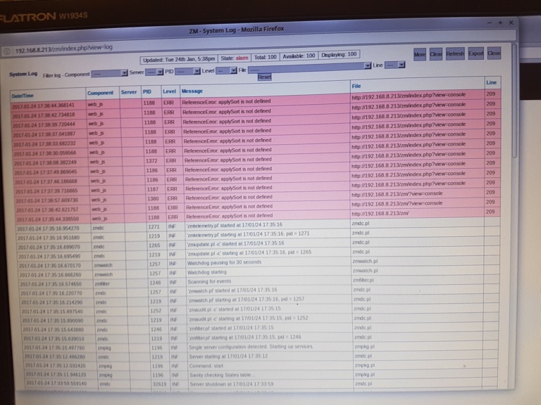

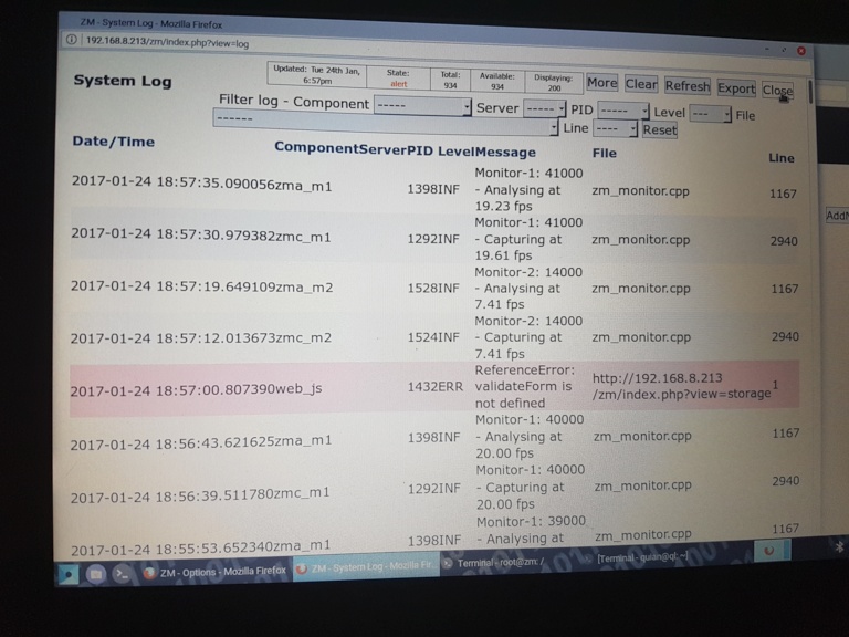

2 small things i did pickup so far. Screens shots of the logs below
1) My console did not show properly at first... I noticed i could see the bandwidth setting in dark so i clicked on it and changed it to high and then back
to low. Then the whole console showed.
2) Also when I add storage paths and click save I get an error or maybe its not.
Otherwise so far all looks good... Will keep you posted
Q :D
